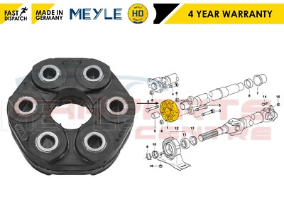

Would Meyle do?
I've ordered another one off AutoDoc for now and will keep my fingers crossed they deliver fast. Is real mixed bag in terms of delivery time but price is good and customer service the same in my experience... so far.
Would Meyle do?
FWIW the Meyle HD versions (not just Meyle) are uprated versions of BMW spec products..I’m using their GUIBO and track rod ends…👌
Heavy Duty is usually great and Meyle is an excellent brand.
I’ve heard people not so complementary about normal Meyle products …my experience has only been with their HD versions…
