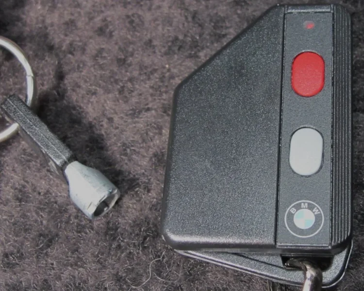

A picture of your type of key or remote might help?
also whats the round small key thing for please?
The key is for turning off the alarm sounder under the bonnet.
