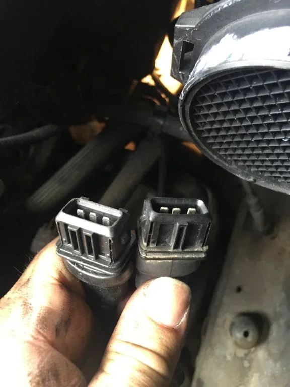

That is exactly what happened to me with the one from Sopers - it had no cable - I also ordered one from my local carparts after that which had the cable but the wrong plug and the sensor was a mirror image of what I needed.....Finally got the right thing and it has made a big difference! Don't give up!Finally got a sensor, watched the online tutorial, removed the vanos solenoid. Damn, wrong sensor! The one on the car has a non-removable cable the one I bought requires a cable. I did check by the reg number at the parts shop but it seems there are two having now done further research. Oh well, I'll pick up another one! Frustrating but interesting all the same as I'm learning a bit more car DIY as I muddle through the joys of older car ownership.
Picked up a new one this morning. Just waiting for the engine bay to cool down as the vanos solenoid is a tad warm at the moment. In the meantime I've cleared the P0340 error so hopefully when the new sensor is fitted, no more error!That is exactly what happened to me with the one from Sopers - it had no cable - I also ordered one from my local carparts after that which had the cable but the wrong plug and the sensor was a mirror image of what I needed.....Finally got the right thing and it has made a big difference! Don't give up!![]()
I give up! Old sensor out, new sensor about to go in when I find out that the connection is different. Aaarrrggghhh! Monday back to the parts shop. Not the most fun, but hopefully when I come to change it, I'll be a lot faster.Picked up a new one this morning. Just waiting for the engine bay to cool down as the vanos solenoid is a tad warm at the moment. In the meantime I've cleared the P0340 error so hopefully when the new sensor is fitted, no more error!

Exactly what happened to me - Mine looks like the one on the right in your picture - I ended up with a part by Intermotor (part19141) - fitted and works a treat - had a lovely blast last night collecting the Friday evening Chinese with the top down! Keep at it! it will be worth it.....NigeI give up! Old sensor out, new sensor about to go in when I find out that the connection is different. Aaarrrggghhh! Monday back to the parts shop. Not the most fun, but hopefully when I come to change it, I'll be a lot faster.
The one on the right is the original BMW part. I'll see what the parts shop come up with on Monday.Exactly what happened to me - Mine looks like the one on the right in your picture - I ended up with a part by Intermotor (part19141) - fitted and works a treat - had a lovely blast last night collecting the Friday evening Chinese with the top down! Keep at it! it will be worth it.....Nige![]()
