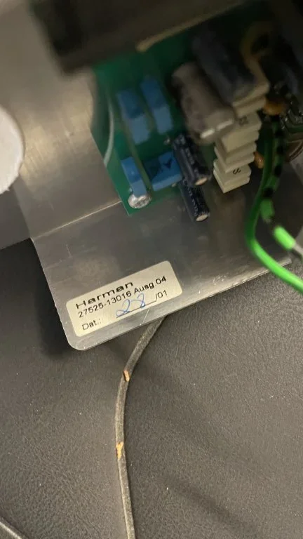

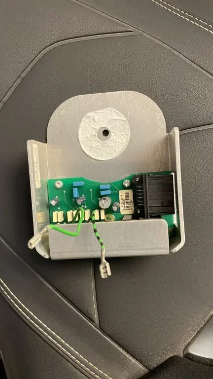

Whilst sorting the swimming pool that is the passenger side of the wifes Z , replacing the lateral acelerator sensor ,sealing the door foams I’ve come across another issue!
The speaker in the passenger footwell seems to click on and off ( almost sounds like a relay latching) , looking at previous threads it seems it has an amp built in, can I upgrade/ replace with a newer set as they are 23 years old or will I need a like for like replacement? Cheers in advance

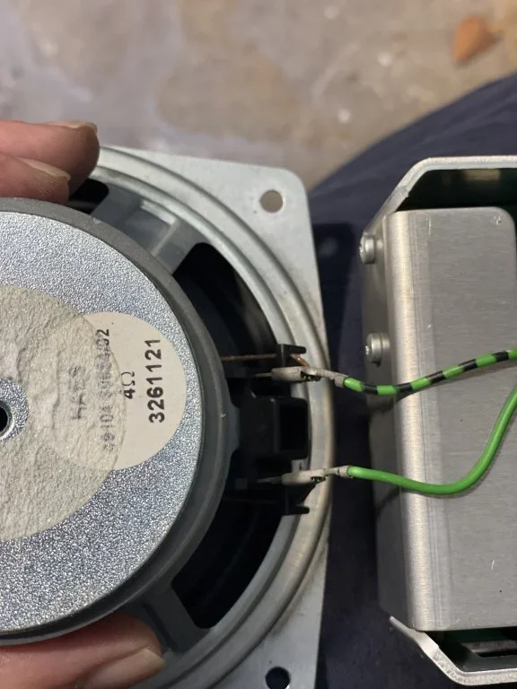

you can replace with whatever 4ohm speaker fits in there and also attach the useless amplifier. Or get rid of it If you have an after market stereo.
If you decide to keep the amp, just glue or use 3M double sided tape to attach it to the new speaker.
while you are at it, better change both speakers with coaxial ones, it will make some but not much difference.
Just remember which way the cables are attached to the old speaker and connect the new one correctly as reversed polarity is not good.
There is a main power relay on the AMP board. They do loose their "sticky" and start opening and closing on there own accord, due to the close proximity of the speaker magnet. I've replaced then in the past and the AMP has continued to function normally. Not a big job.
Thanks chaps, is the power relay something you can buy ?
Yes. It's the blue rectangular box. Get the type details off it and you can buy them.

Find pin 5 on the amp connector. Trace that track to the blue relay that needs to be replaced.
Sorry it's been 8 years since I did the last one, so can't tell you by looking at the photo. Memory fade.
Hey, cannot tell on my speaker wire which is positive or neg as they are both completely grey . :confused:
