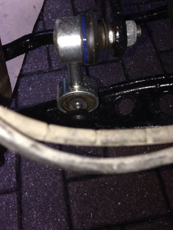

Couldn't wait, I just had to find out what it was. Found the culprit, drop link bottom bolt nylok had gone awol.

I agree, annoying that a nyloc had come off, never seen that before, drivers side was coming undone also, replaced them both with different types now. And of course had to take it for a test drive to make sure. :whistle:

No, they were new Jim. On closer inspection the nylon inserts were too big and the thread of the bolt didn't touch. As I said, never seen that before, duff batch by the looks of it.
