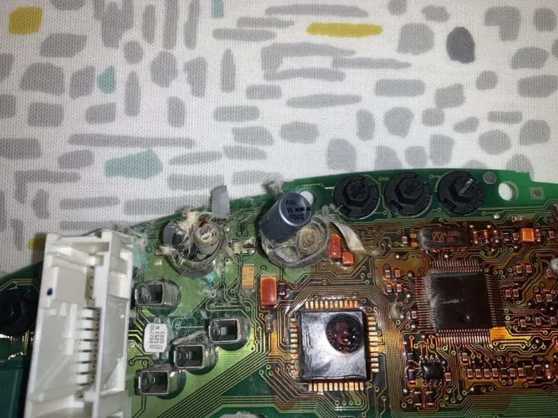

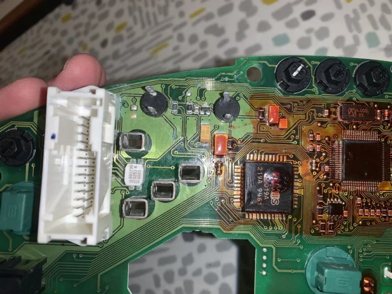

Interestingly, I've recently had an issue like this, but all gauges (temp/fuel/rev/speedo) stopped working at the same time. The rest of the instrument cluster works fine.
Opened up the cluster and found what looks like two blown capacitors on the circuit board. The only thing I can think that blew these was accidentally hooking the car battery up to a 24V charger by mistake (? maybe someone will have more of an idea than me on this). Anyway, I'll be off to get these replaced this week and see if it solves the problem.

Odds on the 24v blew them hope you fix it
