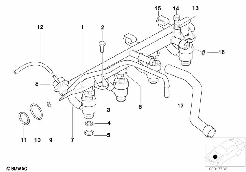

The size is on the appropriate RealOEM page, I used Item 4 from the page for my car...

The o ring in question is no 16

You didn't include the full page from RealOEM, but the o-ring size is usually in the text. See my post above.

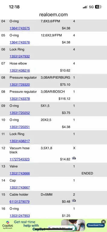

My fuel system is different, and I don't have Item 16.
Hey Pingu,
The part sizes are shown for the injectors seals which I know I can get. However the fuel pipe to fuel rail is not shown
Hey Pingu,
I've had a quick look online and the size isn't shown anywhere that I've looked.
I've looked on the ETK (the BMW partslist database) and there are only two o-rings on the 1.8 Z3 that don't have dimensions, and your's is one of them...
