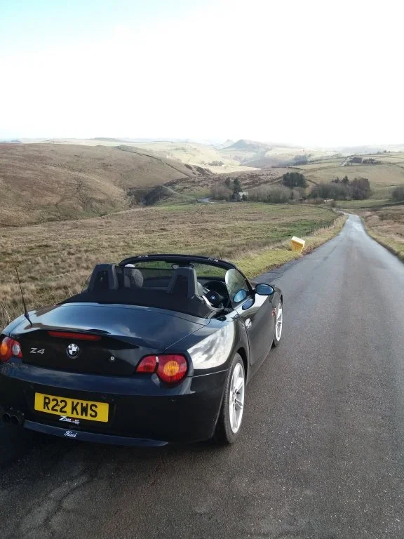

Curious that you say 225 s on 7.5j rims are too skinny. Standard rims on a 3.0l E85 Z4 from new are 8j fitted with 225 45 17 tyres. I have those on my Z4 2.2i and they don't look skinny at all. If BMW think they're ok that's good enough for me
That extra .5j makes a difference and the Z4 was better designed for the wheel to fill the arches I think - the 2.8 Z3 can hide massive wheel back there!
the 225 make it a bit too lively. The 235 has been a nice balance hence trying to stick with it.
