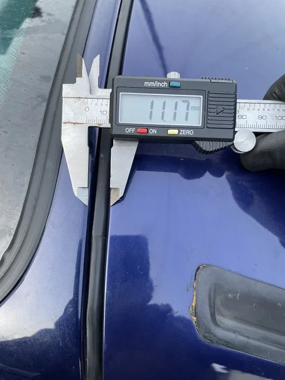

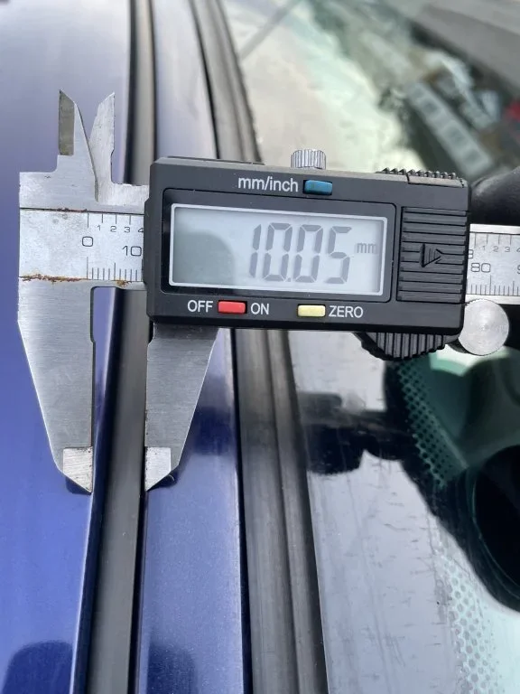

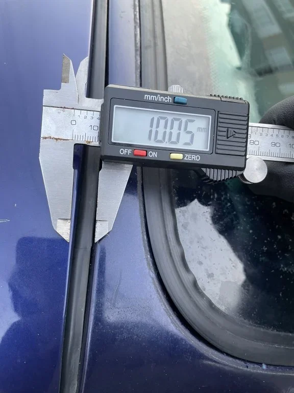

See how the hardtop lines up exactly with the front edge of the rear panel/wing.
This next picture isn't sharp but you see the roof sits snug up against the rubber.
I don't have any wind noise from there

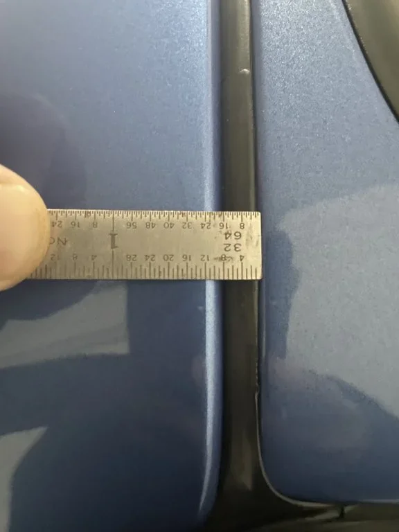

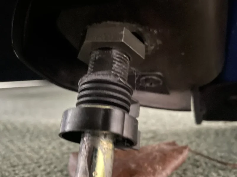

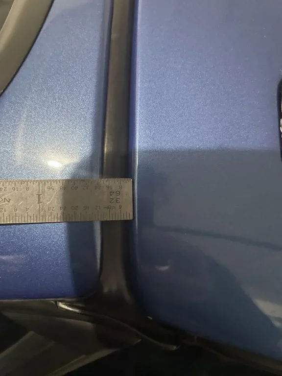

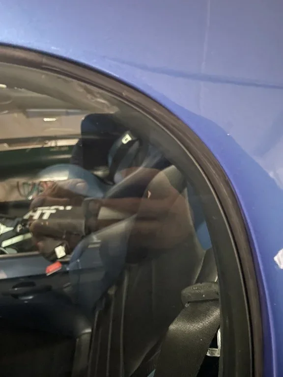

It looks like you need to move forward 2-3mm.
my calipers are at shop. But imperial machinist ruler for reference.
how is window sitting in jamb? Mine needs to slide back 1-2 mm on LHD side.
so picture 1 LHD is too tight.
Picture 2 RH side is perfect on mine.
Picture 3 shows LHD window gasket needs to slide back a ‘scootch’
I think 10/32 x .7913 or 8mm is my target.
also, check A pillar gap for noise source prior to moving. If any gap, try putting piece of something to seal it up.

The screw in your hand the original with the o ring are you saying that it’s a sloppy fit and does not engage into the thread ?
The reason I’m asking is that if anyone drilled out the original ? You should still be able to screw the top down as long as the top had been tapped
But would need to be the right length as per original, another member and myself have just fitted hard tops to both our cars it’s the sort of thing that the more you play with the better understanding of the process you get good luck
Thank you the close up pics
I agree that 8 mm is probably what I should be aiming for along the top
hadn’t looked at the door window gaps all the way round , but that’s something I should look at to see if they are even in uniform and not distorting the rubber.
probably best if I slacken everything off and start again

yes, the base plates have been drilled out and re-threaded to an M10 or M12 Allen bolt (no idea why) so the original torx bolt is too small for the baseplate thread.
i’ve had to use the larger bolt which is a very tight fit through the hole on the window frame but threads into the base plate ok.
(and I have loosened the 3 bolts of the baseplate itself to give me more adjustment.)
I Think, and someone may be able to correct me, that the original torx bolt that you all have for your hardtops does have a little bit of wiggle room as the hole in the windscreen frame is bigger than it needs to be where the thread part of the Torx bolt protrudes.

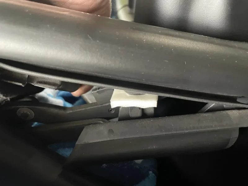

I had time for garage today…. I found couple things related to rattle of hardtop.
1. Upon review of the fitting guide, the post can be adjusted vertically. I found one post on passenger side was loose. Not real loose, but loose.

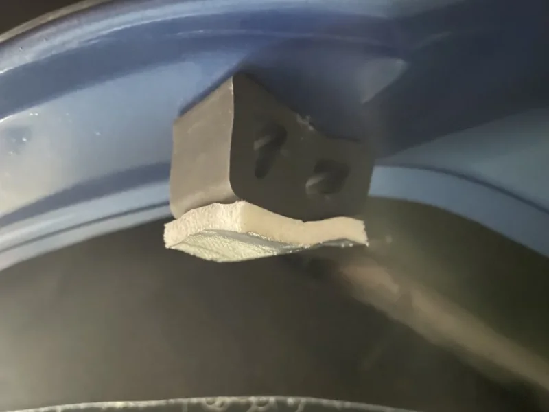

2. The soft top frame has some hard bump stops. I put rubber pieces on it to dampen rattle. See picture.
3. Adjusted the Driver LH side up, about 2mm. Which now allows window to tuck under door jamb gasket. This side also needed tightened.

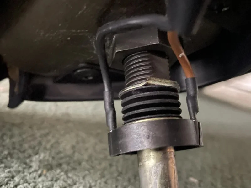

4. Inspected the OEM defrost connector and found one of two wires unplugged. Cleaned and plugged in.
5 inspected rubber bumpers on rear and found them to be pretty stiff. Placed small foam piece to help aid vibration noise. Supplemented the rear painted ‘mantle’ the top rests on, with helicopter tape/film to prevent chafing.

The bump stops for the soft top, another member also found these to be crushed down think this is likely to be the age of them,
So what we decided to do was to fill the voids with a piece of rubber tubing this then pushed the bump stop back as close to the original position this in turn stiffened the bump stop this help to eliminate rattling (maybe worth a try)
To be fair your stops don’t look too bad ?
These foam pads are temporary.
Thanks for note about rubber bumpers compression. Having pointed that out, I may opt to fill the middle with something to expand it to original shape.
May be a whiskey cork…
