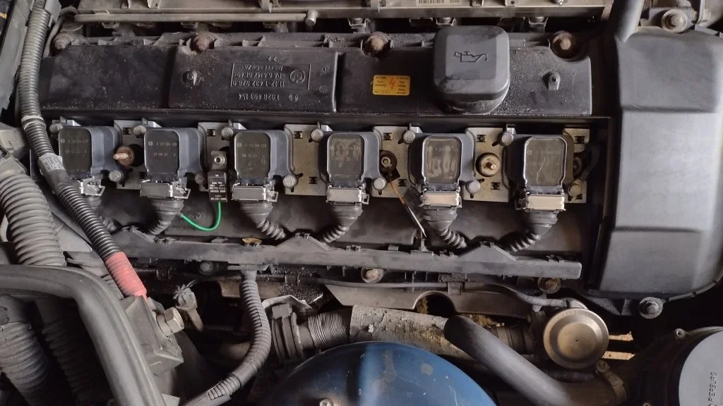

I assume you mean the little part with the green wire. I don't know. I don't have one. There's number on it. Google is pretty good at searching part numbers.
But, just out of interest, where does the green wire go to?
I see what your asking now since @Duncodin spotted the green wire.
I do know that there are the two wires, one brown and that green one attached to the metal rail holding the coil packs, the brown one is an earth wire and I assume the green one you have would also be an earth why its green instead of brown I don't know. I have seen that should these be forgotten to be reconnected when they have been disconnected it will fry the engine DME so always ensure they are reconnected. The black object on the green one looks like some kind of resistor to me, might be shown on a wiring diagram to confirm.
Just had a look through the Electrical Trouble shooting manual in the resources thread that only shows brown single wire as the earth connection for the coil packs, no green wire in the diagram. The Black thing will be a resistor.
Not sure as well but looking at it and where its located i would say its an interference suppressor to stop radio interference from the ignition coils.
Thanks Each. The Electrical Troubleshooting Manual is a good addition to my growing library. Yes, I'd Googled the part number but drew a blank. The green wire disappears into the Ignition coil pack wire cluster bar. I'm wondering if this is a P.O. after market capacitor installed to dissipate the ignition 'noise' to ground; bit like old style spark plug cap resistor? I only noticed it when replacing the valve cover gasket, amongst other maintenance tasks detailed elsewhere for reference.
