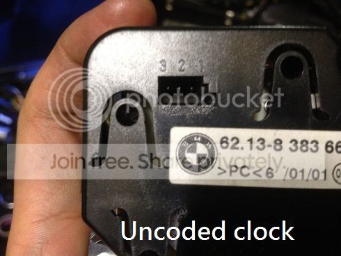

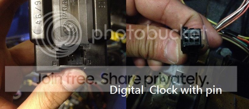

Hi
I have bought the facelift console panel with the analog clock to change my old one but I got the problem and hope anyone can help : (
1. The Uncoded clock have 3 insert but I found 4 wire for the old Digital clock.
2. The function of these 4wires I can check by myself (power/ ground....etc), but the question is I can't check the function for that 3 hold on the analog clock ,
so, any dude can tell me this matter ?
1 = ?
2 = ?
3 = ?
Hi Sobe_on,
I imagine that you have solved the problem in the past year:happy: , but just in case somebody else wants to make the same change, here are the answers:
3) the clock connector http://www.realoem.com/bmw/showparts.do ... g=61&fg=15
code. 61136931929
PIN 1 - wire red/ orange
PIN 2 - wire brown
PIN 3 - wire red/ purple
