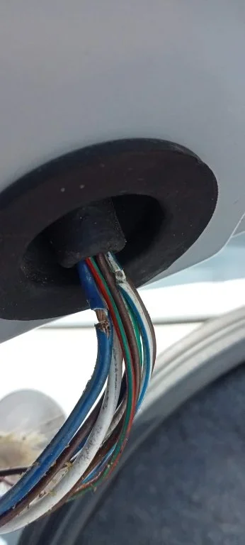

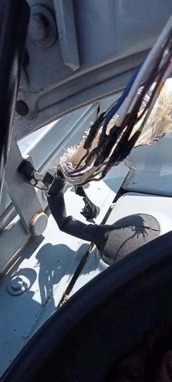

Going down the same route as you, but my fault codes are for central locking (even though everything seems to be working OK). This is what I found, broken cables (2 so far) and looks like someone has been here before. Ordered the replacement loom, just waiting for it to arrive.

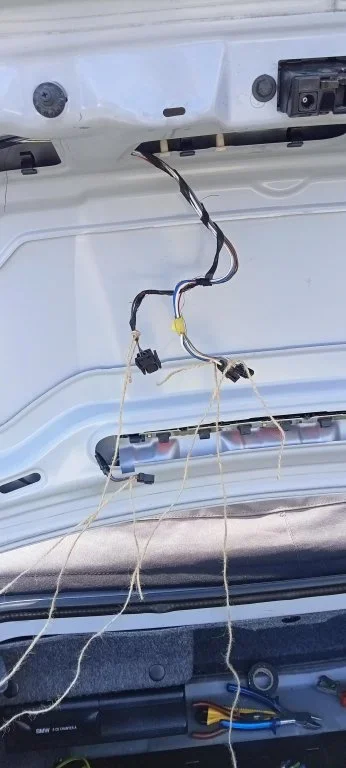

Thanks to a break in the weather, managed to get my repair loom fitted today.
Followed Tony's advice and tied string around all the disconnected connectors before pulling the loom out of boot lid, made reassembly easy.
I was surprised at the number of cores that had been damaged, some well away from the 'bendy' bit of the loom, so worth checking back from both grommets.
Just got finished as the rain arrived, so haven't had a chance to check my fault codes

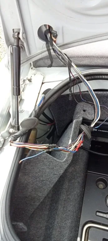

Well it’s finally stopped raining here in Somerset so set about my boot loom repair this morning.
I settled on rerouting the loom out of the boot lid in the same way I have seen on another repair thread, cut all the wires and used a 9 way sealed connector to remake all the connections. Used a grommet in the boot lid hole, wrapped the wires in loom tape. All back together now, everything works. Praying that this will fix the intermittent alarm fault.
