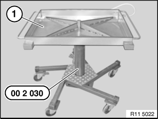

Catch and dispose of emerging coolant in drip tray (1) and if necessary special tool 00 2 030 (universal hydraulic lifting equipment).Recycling:
Observe country-specific waste disposal regulations.

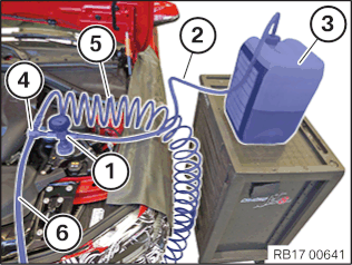

  • 1) Vacuum filling unit with vacuum meter and shutoff valves
  • 2) Filler hose
  • 3) Coolant container
  • 4) Venturi nozzle
  • 5) Compressed air connection (max. 6 bar)
  • 6) Outgoing-air hose (lead outgoing-air hose into a collecting container)

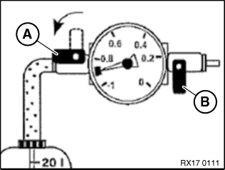

Shutoff valves (A) and (B) of the vacuum filling unit (1) must be closed.
(X) Expansion tank connection
CIcKpJqB

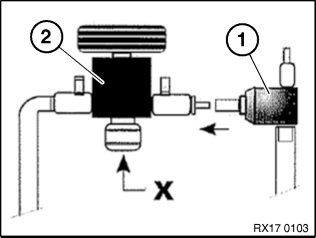

Connect Venturi nozzle (1) to vacuum filling unit (2).

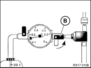

Open shutoff valve (B).
The venturi nozzle produces a flow noise.
CIhEixeo

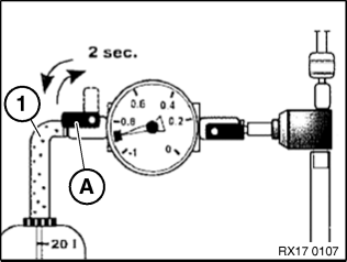

Then open shutoff valve (A) until the filling hose (1) is free of bubbles.
Close shutoff valve (A) again. The filling hose (1) is vented in this way.
CIlCmlhk

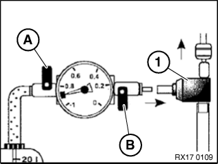

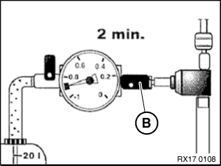

Shutoff valve (B) will remain open. Generate vacuum in coolant system for approx. 2 minutes. The final vacuum is reached at a vacuum of -0.7 to -0.95 bar. Green scale on the vacuum meter.
Note:
The coolant hoses contract during vacuum build-up.
Then close shutoff valve (B) again.

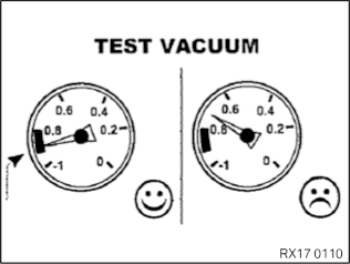

Both shutoff valves (A) and (B) must be closed. Then seal Venturi nozzle (1).
CIWgMqKd
The cooling system must hold the vacuum for 30 s. If the needle in the vacuum meter falls, this indicates a leak in the cooling system.
If the vacuum remains constant, proceed with filling.
In event of leaks, check cooling system for leaks.

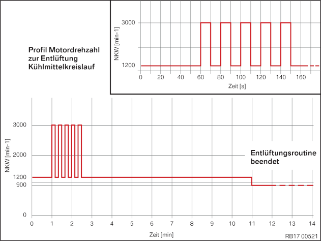

Starting the high-temperature cooling system bleeding routine:
  1. Switch the ignition on.
  2. Secure vehicle against rolling away/driving off (apply parking brake and put in P in automatics).
  3. Switch on low-beam headlights and hazard warning lights.
  4. Check that driving experience switch is not set to ECO-PRO.
  5. Set heating to maximum temperature and turn blower to lowest speed.
  6. Press accelerator pedal for 10 seconds to floor.
  7. Cooling system bleeding routine starts
  8. Then start engine.
  9. Increased idle speed of 1200 rpm is set.
  10. After 1 minute, increased idle position (1200 rpm)
    - Press on accelerator up to about 3000 rpm for 10 seconds.
    - Idle for 10 s.
    - Idle for 10 s.
    - Idle for 10 s.
    - Idle position for 10 seconds.
  11. The high-temperature cooling system bleeding routine has finished approximately 11 minutes after having started the engine.
  12. Engine speed drops to idle speed level.
  13. Switch off engine.
  14. Allow the engine to cool down.
  15. Adjust the filling level in the high temperature coolant expansion tank to maximum.
  16. Close the sealing cap of the coolant expansion tank for high temperature until it lines up with the arrows.
