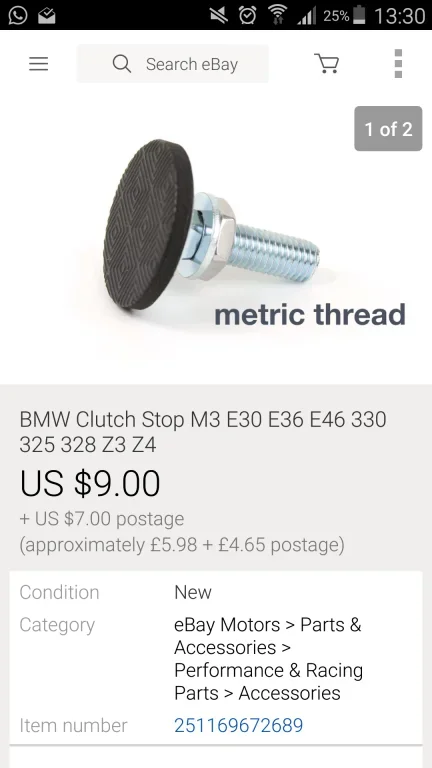

I have read that a clutch stop at about a tenner can improve this as @Bozzy has said it improves with not pressing the clutch so far down.
I presume its because you can set it just below bite so that you know more about where the bite is , the free travel to bite is the bit that causes the clunk as it is the slack remove the slack and eliviate the clunk.
There are good reviews on the e36 forums for the stopper and its a cheap fix if it does what they say.

The car had a standard stop fitted but its very small this just replaces it you can see in the thread :thumbsup:
yeah i can see, its really simple, ill give it a go, for a tenner it may just be the thing I need!

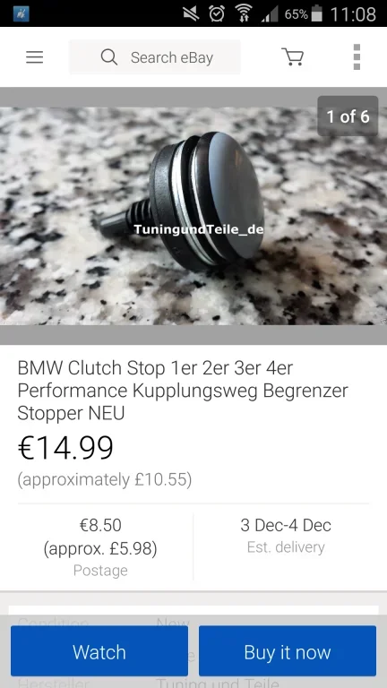

There are two one push in and one threaded i believe the threaded one is the correct one for the zed the push fit is 2006 onwards.
Have ordered one from the states 10.50 delivered will update when it arrives :thumbsup:
nice one, i look forward to see what you think of it :)
No i brought this one.
It lists for the z3 chassis Same manufacturer but different fitment bolt on rather than push in
