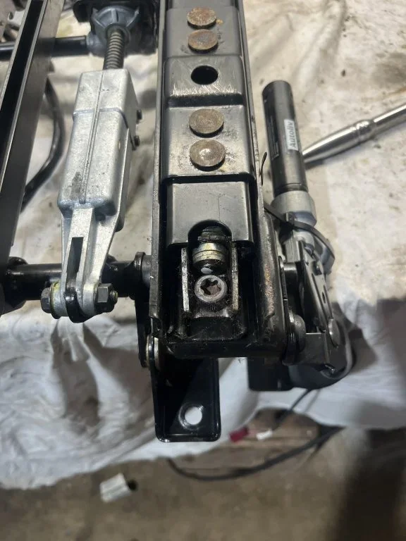

Whilst retro fitting the Aircon system, I’ve had a guy completely replace the drivers side leather bolster and foam on the Z3M seats along with sowing in a pair of new seatbelts guides. He’s made a great job of the bolster, dyeing black leather to blue. Given they are almost 100k miles old they have come up pretty well: (though I do look at my original seats which are in superb condition with a pang of regret).
I collected them last weekend and finally found time yesterday to clean and feed them with Hide Food, before swaping them over on to my original bases.
It is surprisingly easy to remove a seat from its base - it took me 10 minutes, removing 5 bolt/screws and detaching the two cables that allow the seat back rake to adjust.
Then, whilst separated, I decided to fit new bushes/washers in the Fore/Aft electric seat mechanisms - the originals tend to disintegrate over time allowing the seats to rock back and forth while driving.
Again, quite easy, once you work out how to extract the drive mechanism: after removing the large tork screw, which allows the long worm drive mechanism to be pulled out, the seat runner must then be slid back to allow the drive mechanism to tilt down 20 degrees, making it easy to remove.
Once out the rubber bushes in the mechanism are revealed.
My bushes/spacers were in much better condition than I expected, compared to those I found in the donor car’s bases: however as I had bought new replacements I decided to fit them now while I have the seats out.
The long threaded drive has to be removed from the adjuster block as it passes through the spacers: (remember to count how many turns it takes and rebuild later with the same number for both sides of the seat runners).
The original BMW spacer/bushes appear to be made of black rubber moulded as one U-shaped piece: mine are just beginning to break up.
New white individual spacers (that appear to be nylon) are readily available: they are a very tight fit. I gently hammered mine into position, being careful to tap each side, not the weak centre: others have sanded them down until easier to slide in. On the basis that you are doing this to stop the seats moving back and forth I felt “tight” was the way to go.
The most difficult part is the refitting of these driver mechanisms into the seat frame. The long worm drive shaft is driven by a square ended flexi drive, which has to be inserted into the ends of the long screw mechanisms.
The above photo, for illustration only, shows the two parts that must be joined: in practice this union has to be made inside the seat runners making it much more difficult to line up and insert.
The view through the hole is all that you have to work with. I found it useful to offer the shaft to the flexi drive outside of the runner and rotate it to get the squares to align, then feed it through the seat runner and use a flathead screwdriver to help guide the spring wire into the shaft end.
Also note the non threaded end of the worm drive shaft has to be pushed into the black rubber bushes to be fully seated. Once this part is complete reassembly is fairly straightforward.

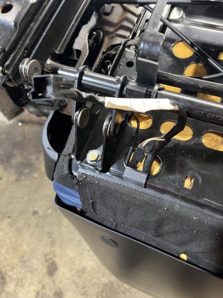

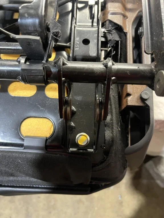

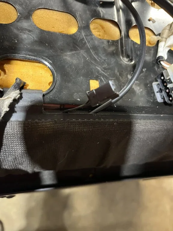

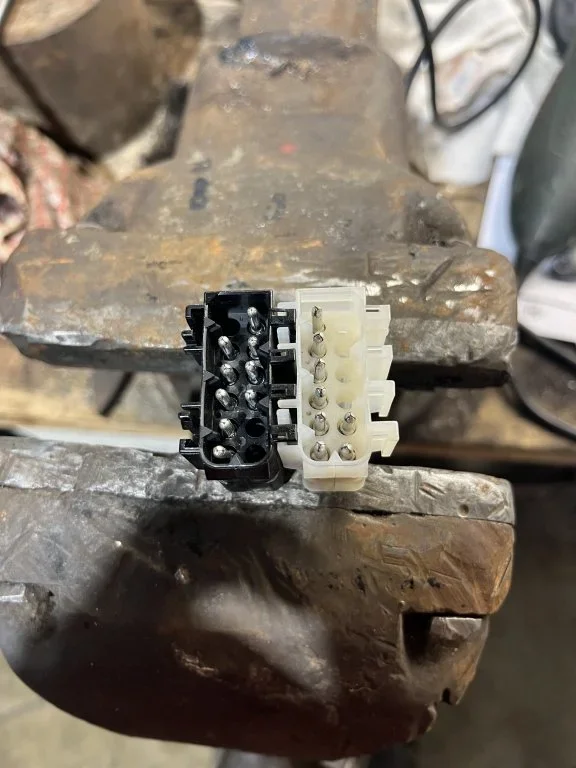

Does anyone know what these connectors hook up to?
I found them hidden under each side seat carpet whilst looking for the heated seat wiring loom

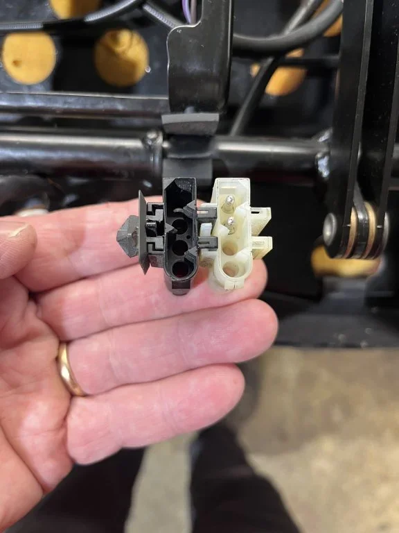

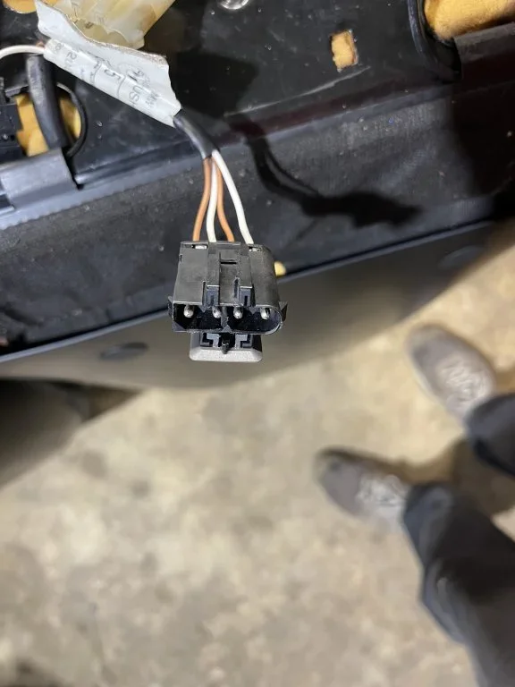

Heated seat plugs have been an itch I’ve wanted to scratch for some time.
Research and a quick check confirmed my Z3 had been pre-wired for heated seats, (as all Z3s were from the factory) however, my standard seats were not heated.
The facelift M seats I’ve taken from my donor Z3 are heated. Unfortunately BMW changed the plug connectors when the facelift was launched, making them incompatible for plug and play retrofits.
Facelift plug
(Note both squab and seat back heated pads are wired to just two pins in the facelift plugs).
Prefacelift
(All four heated pad wires have their own electrical pin).
For my own satisfaction (I must have some syndrome or other🥴) I wanted to retain the standard prefacelift electrical connections: but without any original pre facelift heated seats I did not have the required seat-side plug (or so I thought………).
Research, and guidance from members of this site, informed me these plugs were made by Molex under licence for BMW, so are not made commercially available. I then tried over a number of weeks to obtain a pair from Z3 breakers, but to no avail - (I was offered a pair, but at £40 for two small plugs I snorted and passed!)
I then decided to get creative!
Investigation of the E85 Z4 3.0 I bought as a donor for its M54B30 engine and gearbox (to go into an E30 I’m retro restoring) has a multi pin plug that has exactly the same pins as the 4 pin plug for my heated seats: half way there!
Somewhat surprisingly, (I should have known better by now, as BMW built all Z3s with the ability to accommodate any option) my original seats had an empty, black pinless plug sitting under a white socket (used to power the fore/aft and height adjust motors).
So Bingo!
I have pins, and I now have empty male cases🤗🤗
So this afternoon, I’ve cut the facelift plugs off, de-pinned 8 pins from the Z4 plug, then soldered them on to my M seat wiring and fed them into the previously dormant plug under the seats and now have standard plug connectors to marry up to my loom.
2.5 hours work, and days of (wasted) research, but I’m happy🤗
Facelift plug
Prefacelift
So Bingo!
I have pins, and I now have empty male pin plugs.

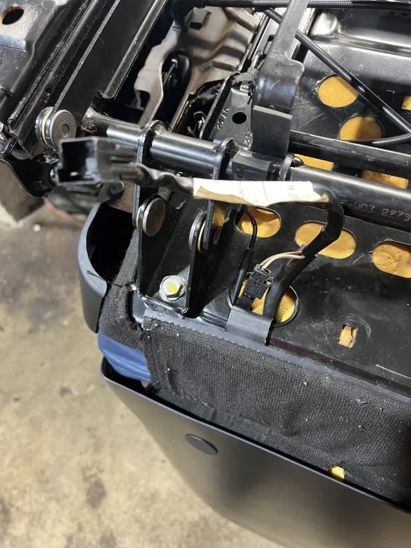

I found yet another one this afternoon - hiding under the M seat bases: it runs up the back of the seat, not into the seat bases. It has two thin black wires - anyone one know what it is for?
My facelift donor has side impact airbags, so I wonder it the plug/wires are something related?
However there is a second plug/control box, which I also think is more likely related to airbags:
Can anyone enlighten me?

If side airbags or passengers bag fitted usually passengers seat has an occupancy sensor so doesn't deploy bag if not required could be to do with that possibly.
Stephen.
Edit
Just looked up your part number.
