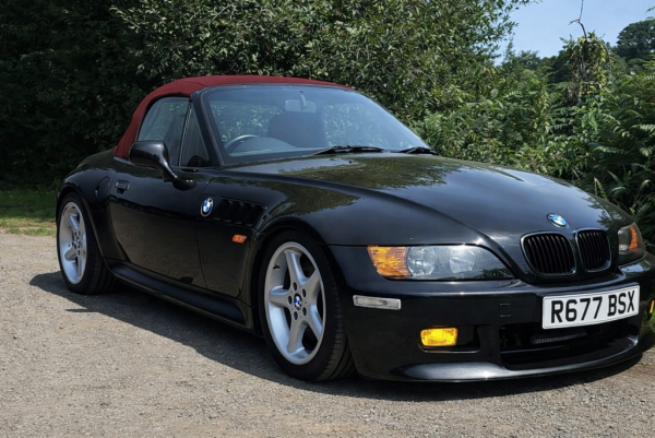

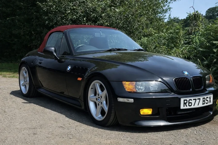

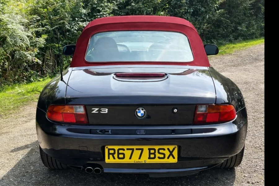

What colour you going forIm booked in for a trip to Swansea in April , Had a good chat on the phone and looking forward to it. Going for a colour change
Im going for red . Should look like this courtesy of chatgtpWhat colour you going for
Stephen
That will look nice .Im going for red . Should look like this courtesy of chatgtp
Unfortunatly im one of the saddos that doesn't get it dirty so thats not something I worry about but I can imagine the marks on anything but black roofs appear quicker.That will look nice .
