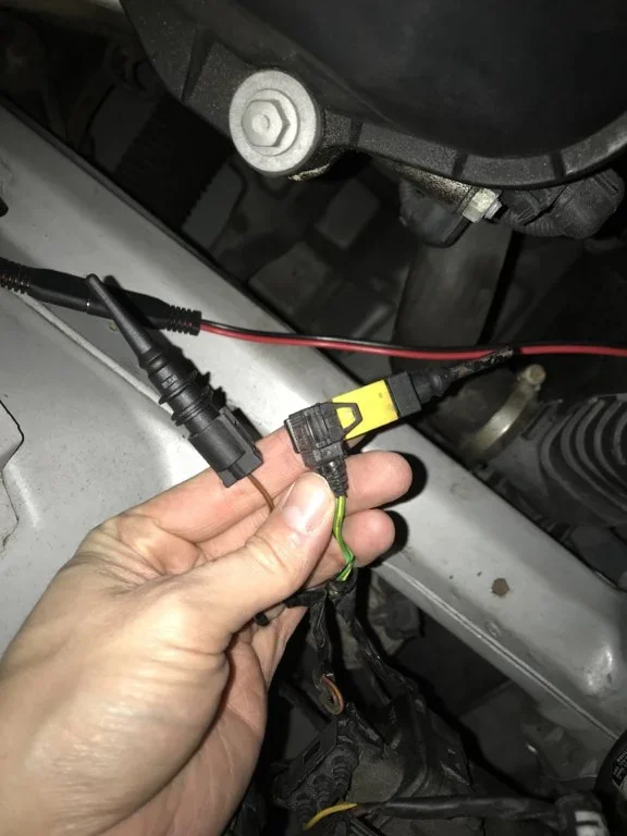

The wires are secured with some tape behind the headlamp, the second picture shows you the actual connector with the dust cap on, after its been released and the tape peeled off.
I found a connector like in the photo with a dust cap on behind the drivers side headlamp.
This one in the photo, is this what it looks like?

Hi, mine worked straight away after i plugged it in, by the way this is the temp probe plug on mine.
I’ll double check the cables and worst case leave it to settle. If it doesn’t work, new ‘probe’
Evening. What year is yours? I’m thinking that the facelift version uses a different sensor? It still doesn’t work on mine
Mine is Oct 97, and this is the sensor on mine.
Tried the exact same sensor on mine. Didn’t work. And I’ve check the cable and sensor. Both carrying current. Might try the E46 sensor before buying another E36 one.
Thoughts on that decision?
Worth a try. Pm any members with a 2.2, I know @pgunter has one.
To all, please note the Z3 has 2 connectors for the air temp sensor. Depending on facelift model. Yellow is pre, facelift is black.

@g8jka its working like a dream now. Like my last post there is 2 sensor types and 2 sensor connectors in the same place in my engine. Depending on which version is yours, will depict which sensor and connector you need to use
It was originally working with the yellow connector in mine (also facelift) but I put the sensor back on my old car when I sold it and fitted ///M gauges. Now I’m putting an OBC back in but can’t get the sensor to work, I think it’s a wiring issue though as the old gauge is still connected. I have 2 plugs, 1 yellow and 1 black which are exactly the same connections for the original sensor. I bought one of the later sensors hoping to splice and fit to the original wiring as I don’t have the black plug you have to connect into. But it maybe connected somewhere down behind the bumper. I’ll have another route around and take the wiring out from the ///M temp gauge it maybe causing the issue.
