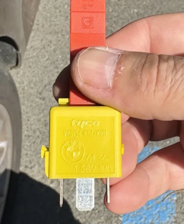

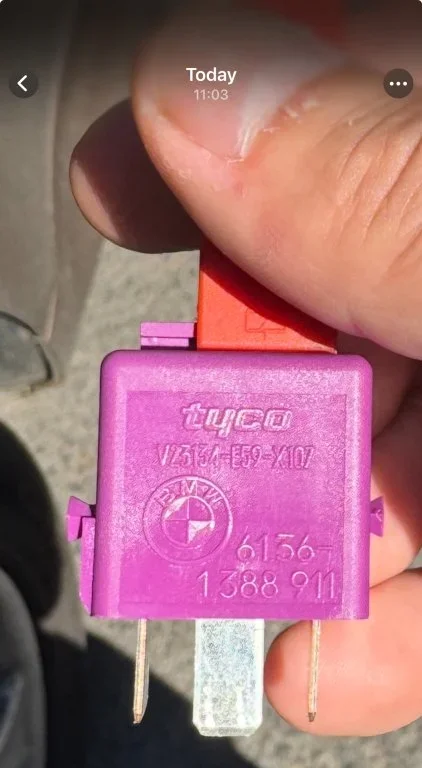

Thank you. Based on the diagram there are 2 fuses 16 and 40 in front of the relays. I checked the fuse box in my Zed and there is no fuse 40 and it seems the box is not equipped with this fuse, even though on the cover of the box it says that fuses 16,40 and 48 are related to fan somehow. 48 is indicated to be under the steering wheel but I can’t see anything in there just the obd plug. How can I test the relays? The one that I believe is for low speed k21 is magenta/violet and has the code v23134-e57-x181 and the k22 is yellow and has the code v23134-e59-x107. Can I reverse them?

Sorry, can't help with the relays as I did not have to fault find mine. But to test them, remove them from the car, and connect 12v across the coil and you should hear the relay click as it operates.
