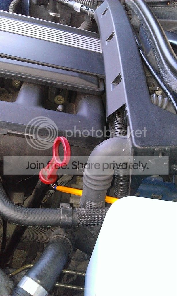

Here is general location, yellow pen pointing.

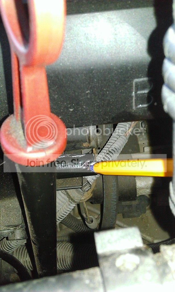

Closer look at the plug.
There is a small blanking plug over a pipe on the rear of the inlet manifold near to the dip stick. When I took mine off it just about fell off as it was split both sides for nearly half it's length and another small split in the middle.
I used superglue to glue the rubber edges together, just as we do when making one off 'O' rings, and then wrapped tape around to make a temporary job. When refitted was a much snugger fit.
Pt No 11611727176 @ £1.45, BMW OEM
