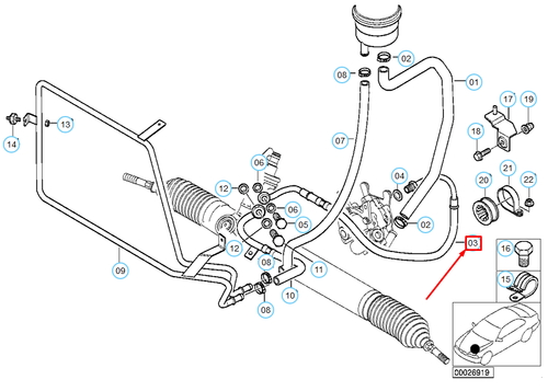

Can anybody help me work what is meant by ‘high pressure’ side/pipe work.
From real OEM it seems it is part number 32416754173
(Item 3 on the pic).
Is there anything else needed when swapping this out?

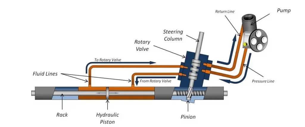

I am not sure how a hose could make noise or why a braded hose would solve the problem?
The pump is just a small hydraulic pump. Hoses simply connect it to the rack. The rack has valving in it that will increase the oil supply based on steering demand.
If it was only happening in one direction I would suspect it to be in the rack itself.

If you turn the steering to full lock and keep pressure on the wheel does it continue to make a funny noise or does it stop?
When you are at full lock and hold the wheel the valves inside the steering rack will remain open and the pump and system will run at full pressure.
The power steering pump is normally a vane pump with a high pressure relief valve. Full flow passes to the rack and returns to the pump in a loop.
When you turn the wheel and need steering assistance the valves in the rack will start to direct flow to whatever side of the piston needs it. This increases pressure until you reach the relief valve limit. You can hear this when you turn against full lock.
Very simple system but the valve in the rack is very clever.

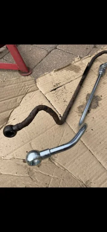

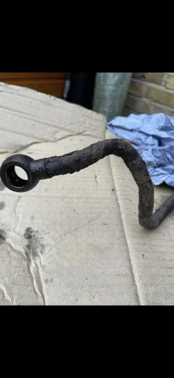

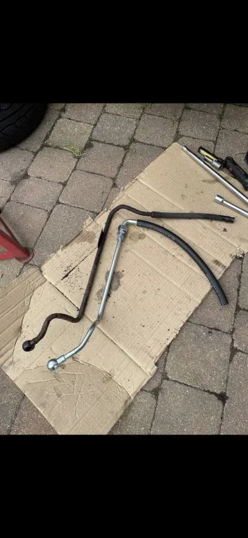

Saw this thread and thought I’d give another thumbs up for the Zedonist. (no association- just impressed with their product)
One of my steering pipes reputured on my 2.8 track car at Thruxton, which rather ruined the day😳
so whilst doing some repairs/replacement, I thought I’d replace the others.
ordered the one from the Zedonist
was very impressed with the kit that turned up.
everything included correct brackets, bolts washers etc and a quality bit of kit and was easy to fit on the car.
if you haven’t done so recently, you might want to check your steering pipes as you can see from the pictures of mine, the ones that didn’t blow at Thruxton were clearly on their last legs. They get the full force of all the grit stones and stuff thrown up from the road.
