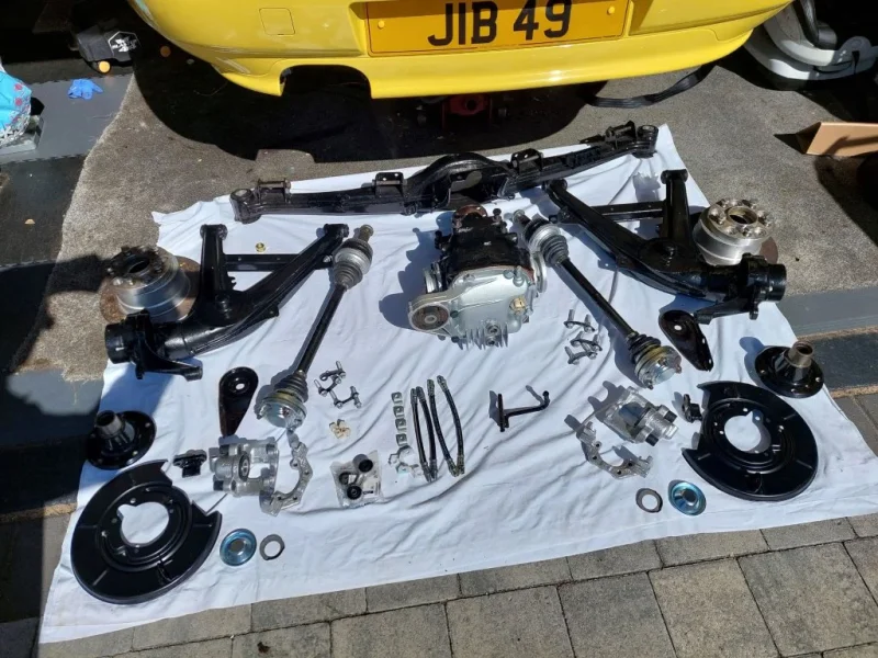

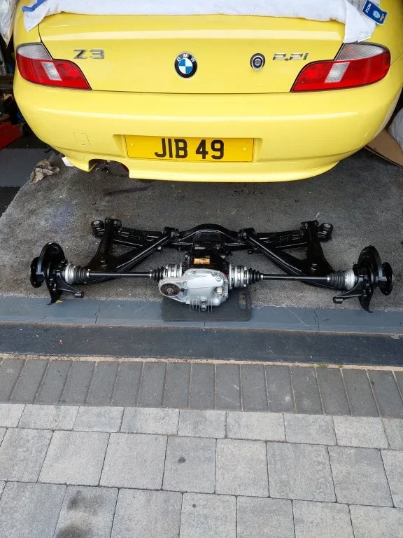

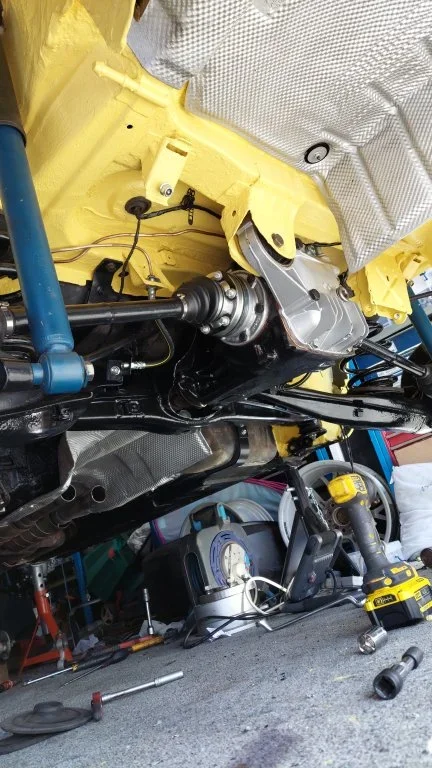

There have been many write ups about rear axle rebuilds so I'll make mine the shortened version,
I've been promising myself since winter 2021 to complete the overhaul of my cherished Zed.

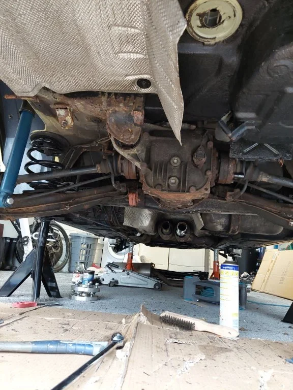

So I decided to start in March 24 after purchasing some serious axle stands from SGS. After stripping the whole rear end into individual components. Spending a few hours here and there and it's now complete and finished.
All necessary components blasted and coated
Differential partially dismantled new seals fitted

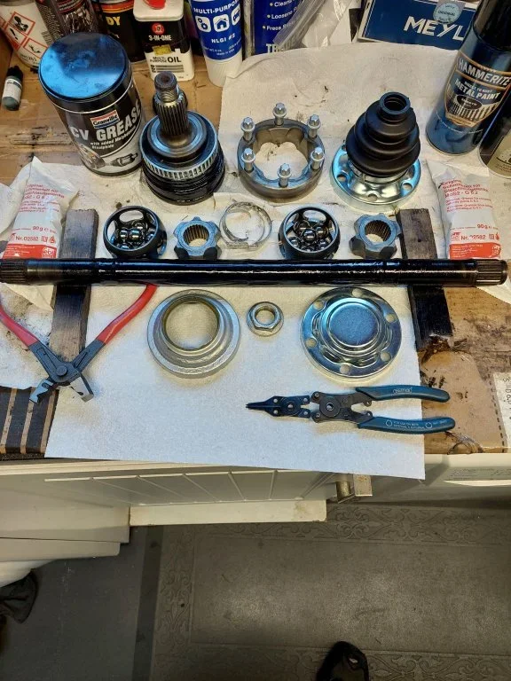

Drive shafts dismantled cleaned rebuilt and re greased with new Inner and outer boots
Prop shaft flexible coupling, centre bearing carrier and guide renewed
Gear linkage bushes and shims replaced
New drop links
ARB bushes replaced
New differential mount
Gear box to cross member mounts replaced
Subframe bushes renewed
Trailing arm bushes renewed
New brake cables
New flexi hoses
New rear wheel bearings
Discs and pads
Disc backing plates
Calipers blasted. coloured. new pistons and seals
A mix of new brake pipe clips and bolts etc

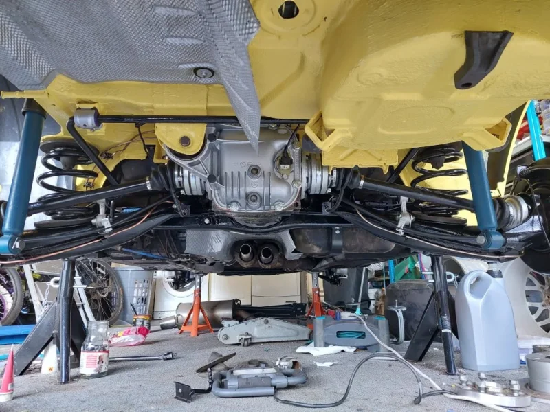

Underbody cleaned treated with anti rust preventer and coloured
OOOOP'S I nearly forget, A set of Mazza's replacement tank straps, 'PERFECT FIT' .....
So pleased it's now finished and ready for the summer. I have been on a 30 mile test drive, completed without any drama, with no leaks and thankfully nothing has fallen off...... =))
Worth a mention, the gear change is superb, having changed all of the bushes and being re shimmed the gear change is unreal, what a difference.

although the end result is very pleasing and the improved driving and handling is superb, I think once is more than enough.

Fortunately I have been involved in selling parts for many years, I have many local garage proprietors that I know personally so I called on them to remove and replace the bearings with a press.
