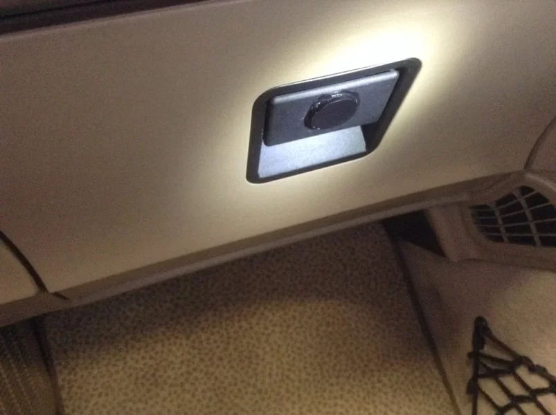

Anyone got any ideas how to get the lock out of the glove box handle?

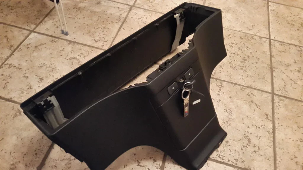

I want to copy the sequence of the pins on another cylinder which I will fit in my rear storage console and I'm afraid of damaging the glove box lock

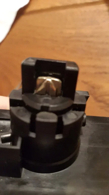

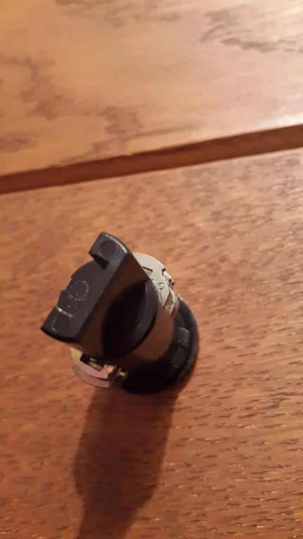

I used a hammer and a nail to drive the pin out to separate the handle

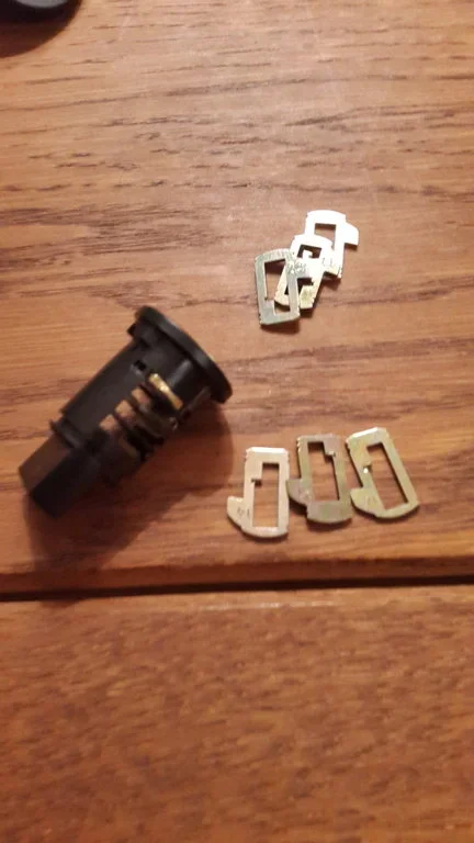

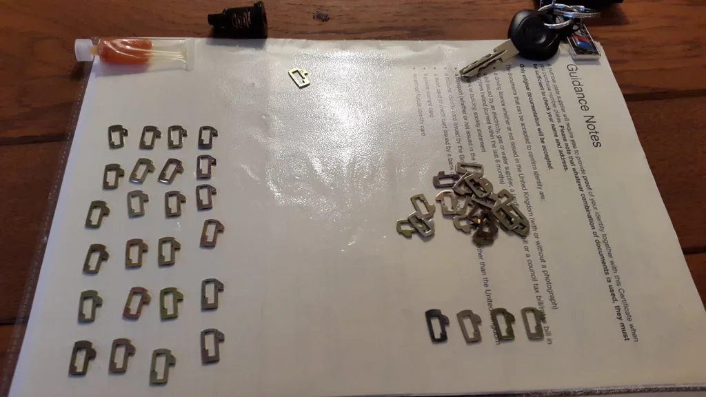

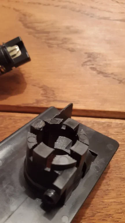

Prise the four clips that hold the cylinder in place with the key in the lock so the tumblers don't spring out
Slowly remove the key, then note down the tumbler #s in sequence
Tumblers inserted into the new lock cylinder and taped up ready to fit in to my rear storage box (when it arrives) :)
@David It took a lot of force to get both pins out, I can only recommend a long nail and a hammer :D

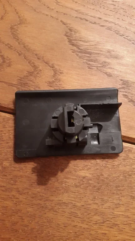

Thanks Ash, I had presumed that the two pins did not actually meet in the middle, and had a bit of plastic between them? Presumably not then??
@David No, simply a hollow straight through
This is the inside of the handle, so as you can see the middle section where the red line passes, is where you will be pushing the pin through

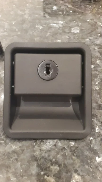

I think some previous owners tried the hammer and screw driver method to mine at some point and I'm now left with this!
At leasts its unique and a semi decent repair.
