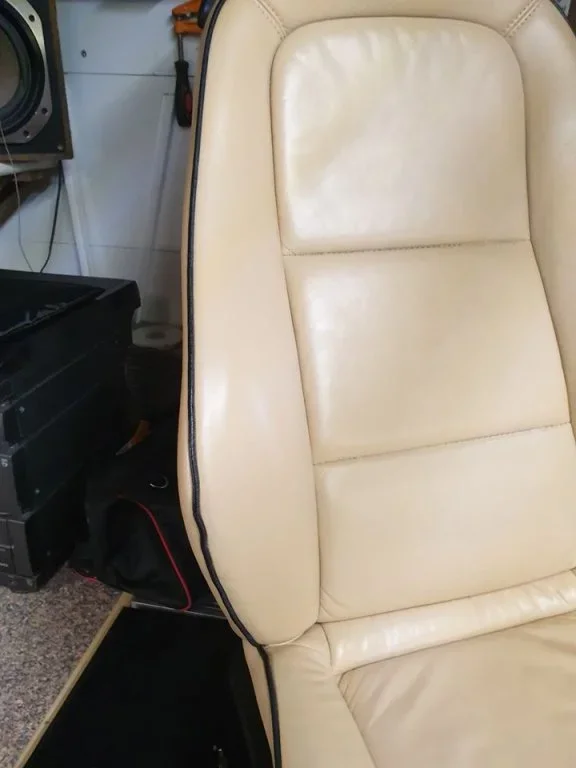

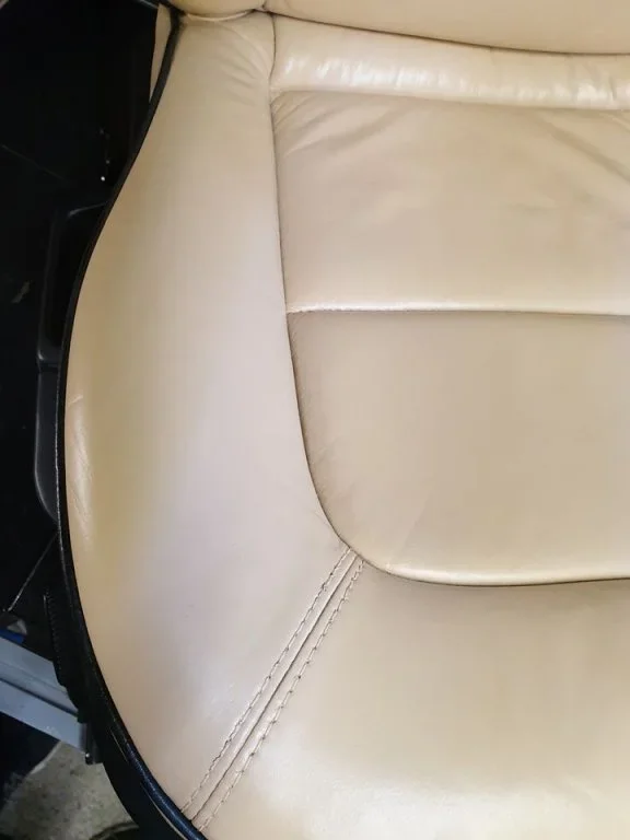

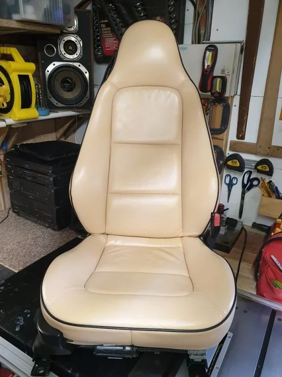

So, decided to have a plunge and do the drivers seat refurb. With the Orinoco being an individual colour i had to have the colour mixed and would like to give a shout out to Colourlock for getting the dye spot on.

They are looking nice do you have any before pictures :):)
Thankyou. Unfortunately not, the seat bolster and seat base were badly worn as you would expect with a 21yr old car. The bolster was nearly through but i have caught it just in time. It was my first attempt at this kind of thing so i am very happy with the way things have turned out.

How did you get on with the seats being piped.

Thankyou. I wish i had taken photos before hand. I masked up the piping leaving a few mm overhang, then carefully slid a butter knife down along the joint to get all the piping covered. I then touched up the piping using a touch up sticks.

Btw is the product sprayed or sponged on? And did you need to seal it afterwards?

Thankyou. The dye is the sponge on type. I found the right technique for applying it evenly after I had done a couple of coats. Then it has a leather creme product as a protection to finish with.
