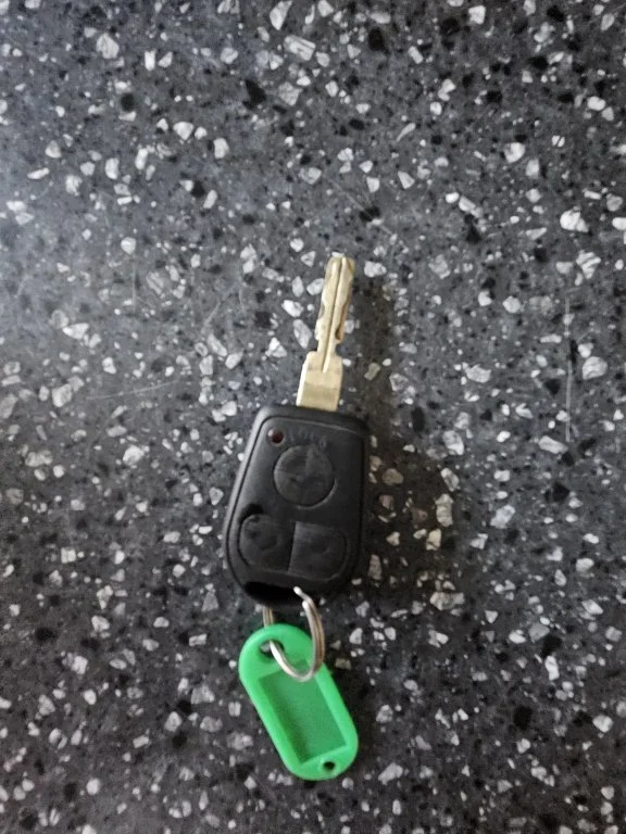

Hello all, some progress has finally been made!
I’ve taken apart the dash and removed the alarm module. I unplugged all the connectors and plugged them back in, and now the hazards no longer go off every time I touch a door!
Now I’m trying to get the electric key/fob working. The key I originally had has never synced with the car. Since I now have the alarm module out, I’ve been able to put it into pairing/learn mode, but still no luck.
Following advice above, I bought a matching key from eBay, but that won’t sync either. I’ve tried the usual syncing methods:
- ignition on/off procedure
- holding unlock while pressing lock 3 times
- holding lock while the alarm module is in learn mode
Still nothing.
My question is: all the YouTube videos for this alarm module seem to show the older “brick” style fob. Does this mean I’ve actually had the wrong key/fob for my Z3 all along?
Any advice would be much appreciated!

.............My question is: all the YouTube videos for this alarm module seem to show the older “brick” style fob. Does this mean I’ve actually had the wrong key/fob for my Z3 all along?.........
It's some years since I looked into it and the memory fades, but you may well have had wrong fob.
Unfortunately our cars were built in the change-over period from alarms which were dealer installed to factory fit. Dealers were using stock up off their shelves. Mine is Dec `97 build and alarm was dealer installed. I also helped another member re-programme his spare fob on a `99 model- both were `house brick' fobs but the module boxes were slightly different.
Some photos in this, where you can see part numbers for comparison. https://zroadster.org/threads/3g-ews-remote-fob-programming.3384/
I fixed mine a number of times and programmed different fobs over the years, but in the end the system gave up and I removed it. Just use the key now.

Thanks, Jonco — that all makes sense.
When you mentioned you'd programmed a few remotes, have you ever successfully programmed a 3-button remote like mine using the alarm module's learn function, or was it always the older brick-style remote that you managed to sync?
I've gone ahead and ordered a £50 brick remote from eBay, so fingers crossed that does the trick. If not, I'll probably replace the alarm module and see if that solves it. At this point, I'm determined to get the remote locking working!
What has me stumped is the possibility that my 3-button key is simply the wrong one. The key itself looks well used, so I wonder if a previous owner replaced it years ago and just chose the newer-looking key without realising the remote and alarm module still need to be compatible and sync correctly.
