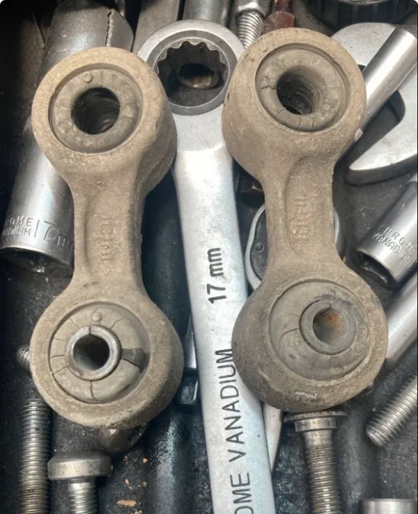

Classic squeaking from rear is attributed to rear shock mounts.
Mine came from worn stabilizer links. Pretty straightforward.
Noise was from mild swaying when car was cold.
pn 3003305101
