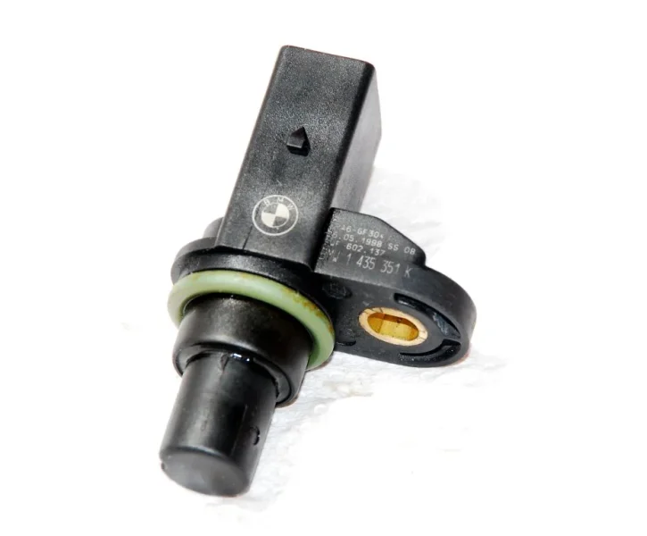

On the cam sensor front, I always pull out my exhaust cam sensor at every oil change, and wipe off the accumulation of tiny metallic particles from the probe as a simple preventative measure. The inlet sensor requires removal of the VANOS inlet solenoid, so s a little more involved - I have only done this once.
