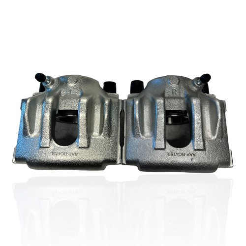

Front calipers are cheap (rear not so) ..almost worth changing them every time you do the pads. They will need to bleed your brakes but labour seem excessive
eBay link
The callipers are different for the 1.9 and 2.8 so be careful with eBay sellers who don’t always specify. The labour charge you were quoted is, what around 3 hours? I’d take that.
