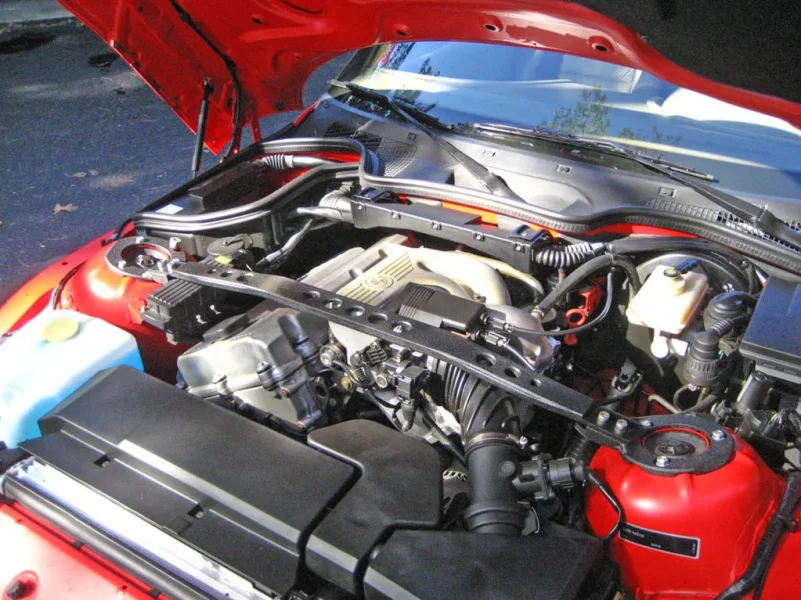

I see lots advertised for the 6 cyl but non for the 4cyl. Or don't they need one ? JIM.
Their need is the same as a 6. But the throttle body prevents most bars from going straight across over the engine. So all the 4-cyl bars are bent in a bow shape that goes behind the throttle body. They look as limber as a crossbow, being arched in two dimensions:
http://www.horsepowerfreaks.com/cart/227218
http://www.cosmoracing.com/productinfo.asp?cid=241&pid=1276
I had Strong Strut machine the underside of their 6-bar to fit my 4:
http://i49.photobucket.com/albums/f280/vintagefortytwo/BMW Z3 Related/Strut Bar/SS192_zps992d7f62.jpg

There is no difference in warranting between a 4 and a 6. The strut bar stiffens both equally. There is a small reduction in cowl shake over railroad tracks, etc. As for handling, there is no difference for me because I am a gentle driver. For a bar to improve handling, enough cornering stress must be imposed to try to bend the top of a strut tower outward. I think only tracked cars see that.
