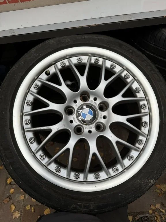

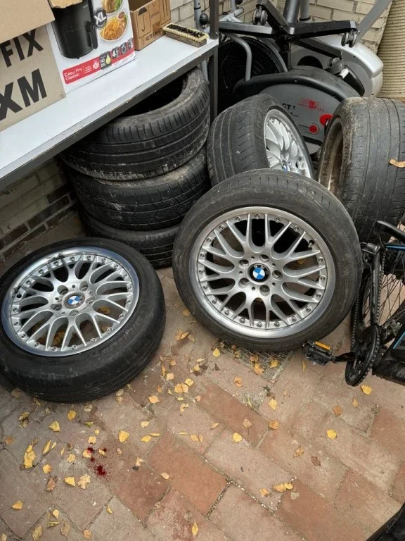

Hello all,
I am considering buying a set of these wheels. The set being sold are RS 765 (8J) with an ET (IS) or 47 - 17 inch rims.
Would the standard setup be square or staggered, and if staggered, what would be the width and RS number?
Does anybody have these fitted to thier Z3?
They are all stamped and marked as per a BMW Wheel so i presume they are original unless somebody can advise me otherwise.
Were they an option for the Z3?
The seller is asking ca £400, seems an ok price.
As ever any advice much appreciated.

As Andy has stated, that is cheap for these wheels, as long as they do not need a refurb. A refurb could cost upwards of £100+ per rim.
I would 'suspect' that the offered cost of £400 is based on the fact that this set may all be 7.5",
The correct set up should be 7.5" front and 8.5" rears. easily distinguished by the deeper dish and wider tyres (245 40 17) on the rear wheels.
They will look recessed on the rear if they are all 7.5" and you would have to fit a spacer to bring the wheel out to fill the arch,
I would guess that a set of Genuine 7.5 front and 8.5 rears in really good condition with no damage and the polished lip still showing would be circa £800,
** Many sets have been painted completely silver to disguise the corrosion on the outer lips.
Hope this helps

In comparison to your current style 55 wheels, the 8x17 ET 47 rims (originally for the 3 series E46) will protrude 12 millimeters in the rear which will definitely look good.
Here's a picture of my own Z3 with style 55 wheels and with BBS with similar dimensions (8x17 ET 40).
See how the wheels fill out the rear wheel arch much nicer?
17x8 et 47….very rare e36 wheels.
Fitment will be fine on all 4 corners but won’t have the dish ratio that creates the nice aesthetic.
Considering how rare these are, £400 is good value. The e36 fraternity would beat doors down for them.
