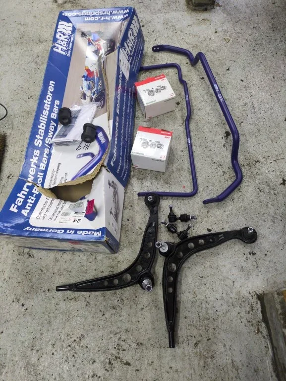

H&R bar, Ford drop links, control arms and wheel bearings.

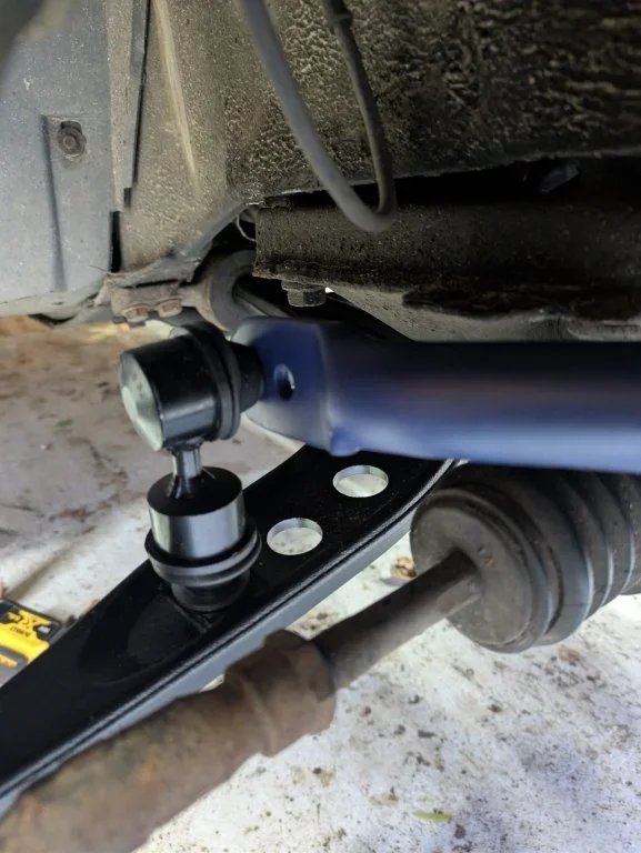

Managed to get the lower arms and sway bar fitted today.
The Ford drop links fit really well.
They're really good. They look alot bigger than the stock drop link. Time will tell now if the quality is there.
