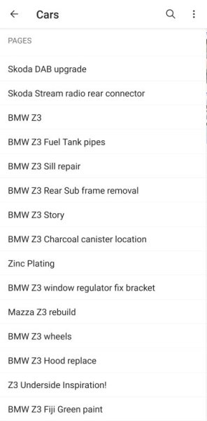

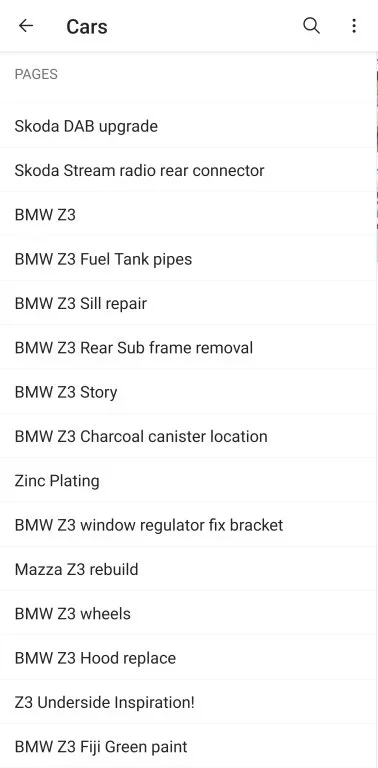

I know I'm not teaching you to suck eggs, but one thing I find I can't do without is OneNote App.. it's how I keep tabs on parts, projects, ideas, costs, progress photos, youtube clips..if I upload and manage on my PC, I can then sync it to the OneNote app on my phone so I have instant access...
