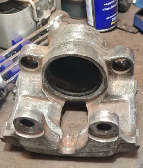

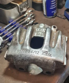

ooooooooookay.... let's try again on a NEARSIDE caliper this time eh ?
It's the one on the far left of my previous post....
apologies if I've gone over this several times but it REALLY does work for seized pistons. Tried the foot pump and no good, didn't budge... so.. here we go...
leave the bleed nipple in and screwed in.... then screw a 10mm union into the flexi hose connection...this is purely to minimise air loss. I then used a pump adaptor for a beach ball or "fitness" ball, which you have to hold and push down on.
now admittedly at first it just didn't want to budge, BUT there was no air leakage, I was actually leaning on the pump with my bodyweight.
so you know what's coming next don't you.... yep, the sockets and extension bar trick, I now have 100% success rate with this method. Turned it enough to break the seal but it still needed the piston tapping on the edges with a hammer. It started to move again so I squirted the sidewalls with WD40....quick turn and it broke free....
Then it was a case of re attaching the foot pump and out she came
Then a good clean up to get all the rust out the way, then coated in brake cleaner and dried off with the coolest heat gun ever made...
then that was it, all prepped for paint, Hammerite Silver Smooth and left to hang overnight....whole job from start to finish was 1.5 hours.

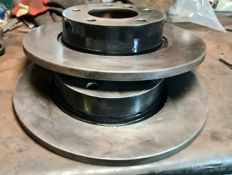

then I thought I'd clean up and paint the discs..... too much ?.... no ?.... maybe ?
Good call painting the non functioning part of the discs, rust around the "bell" part drives me mad, when we got the daily 3 years ago I sprayed them with Hamerite Satin black, so it was only a thin coating. This weekend I decided a refresh on the front was needed and am impressed with the longevity of the spray, proper brush job now and they have come up well. I put new discs on the back a month or so back and these parts are rusty as hell, will be done as soon as we get a good weather day this week. You can buy discs with a coating that is supposed to stop this but in my experience it is a waste of money and only lasts a month or so.
cheers @1955Davidr .... yeah I know it may seem like overkill but just wanted to see how it looked...I'm thinking of going mad by zinc plating the pad retaining springs 🤣.... but we'll see.
