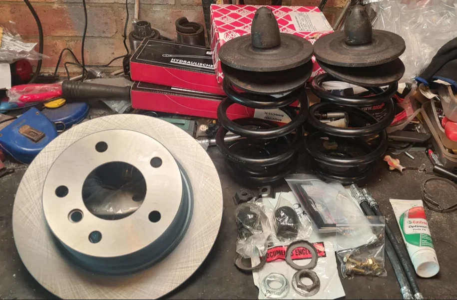

first was to gather my war chest of parts I was going to need for the day..

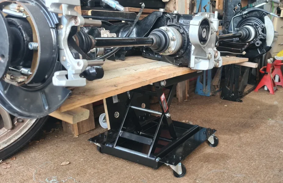

tried out the motorbike lift... and.... it was worth it's weight in gold.... I thoroughly recommend getting one if you're about to embark on a rear end refresh

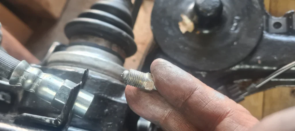

Then I hit my first gremlin... one of the brake flares was too shallow and even tightened fully was rattling in the union
but fear not, thanks to the hand held brake flare tool, redoing it was a doddle
There, much better !!

a moment of madness came over me and thought... let's do it now.... so wheeled it out under the car
I was having a bit of trouble with the assembly tipping slightly backward on the homemade jig.. so used a trolley jack to GENTLY support the diff
I noticed the prop shaft kept catching on the subframe but the great thing about the lift was the control you get....I managed to wiggle the prop shaft and Diff enough to get one prop shaft bolt into the diff which stopped it catching
and we're in !

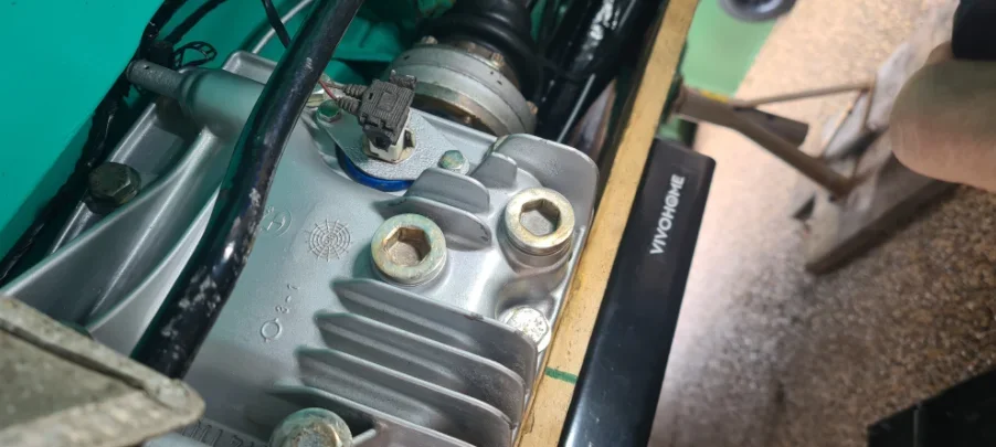

Had to tidy up that speed sensor with a hit of Hammerite Silver and zinced bolts...too much?... no ?
It was fitting it made me realise something wasn't quite right...
If you look at the washer on the long Diff bolt. It looks to big
Then I looked at the Diff bush bolt and realised I had no washers on it !!
ooops !... I'd put the Diff bolt washers the on the cover.... :whistle:
I realised I had two thin ones left over, and THESE are the ones for the cover bolt !
Soon rectified by taking the Diff bush bolt back out and putting the right washers on the right bolt !!... There... that's much better ! :whistle:

So with everything on the subframe now torqued up.. it was time to drop the lift! Just to show you how easy it is, just use it like a vice handle
