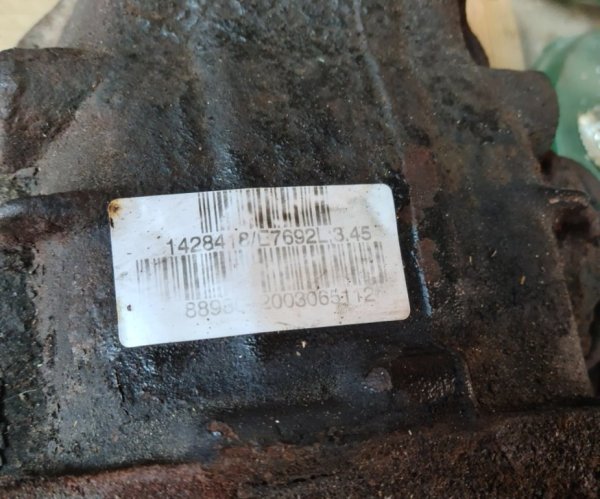

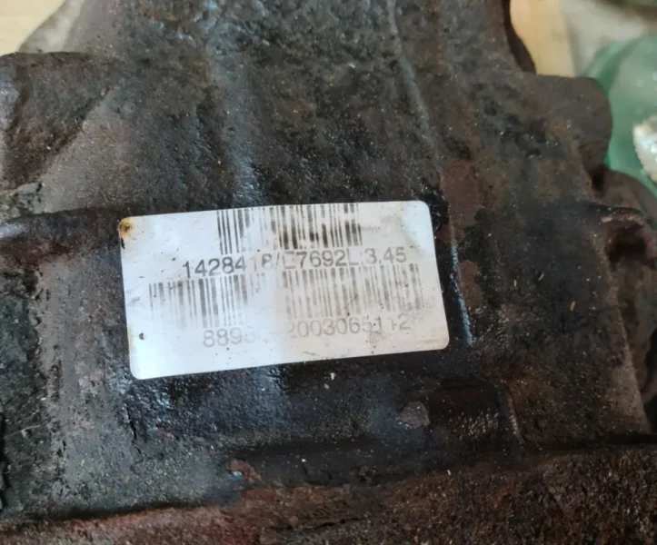

only slightly more positive news... the Diff looks very decent... all this was a soaking in Gunk degreaser... no scrubbing or anything...think it'll come up a treat
oooo forgot to say...It's a 3:45 ratio Diff.. is that usual for a 1.9?

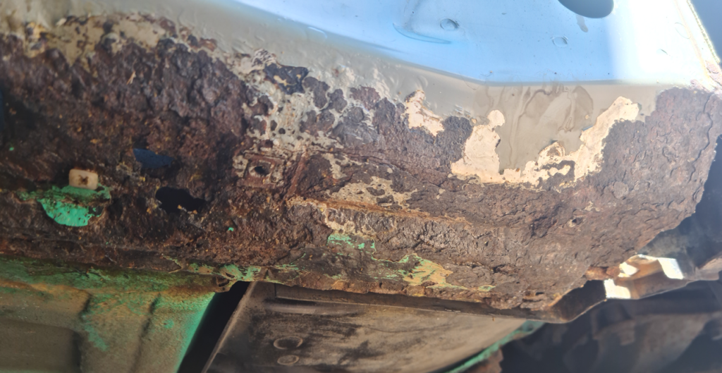

and that is precisely where my luck ran out....the Bad news........ I have holes....
with the jacking pad removed
everything around the holes is solid... passed the screwdriver jabbing test
then I tried the offside rear jacking pad.... another hole...again, everything around it is rock solid
now I don't know what my options are now...... get a mobile welder ?... or wait until the car is back on the ground and truck it to a shop ?
Honestly you need to be brutal and get to clean metal even if it mean chopping some out. A good welder should be able to make a near seamless repair, have a check in my thread in the my sig mine was a lot worse.
cheers mate...will have a looksie
@Althulas just been going through your build ...wow !..... I've ordered one of those jacking repair plates you suggested and I'll start grinding away...cheers !

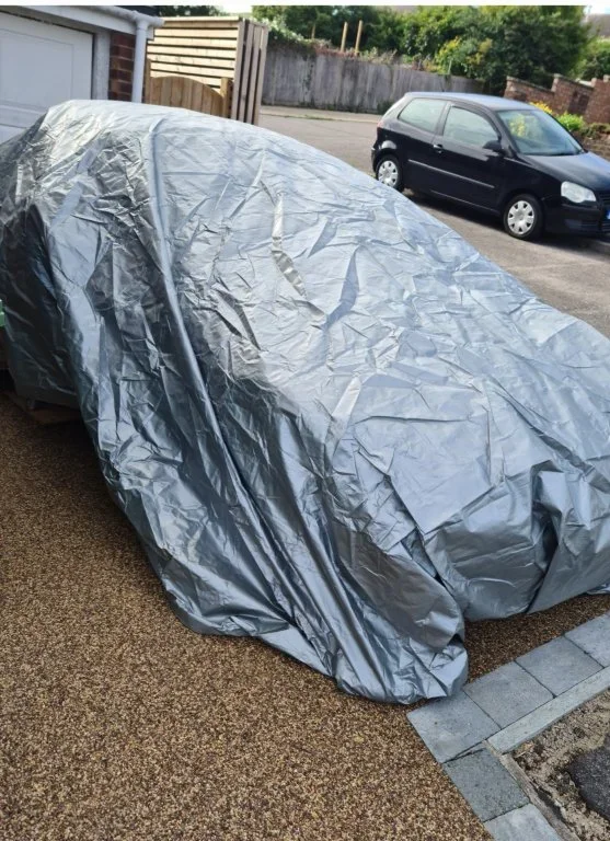

car tucked up for the night

Is the sand colour gravel yours then? Cos the bit behind where the Z currently is looks more level, so just wondering the it isn’t there instead
it's permeable resin mate....NOT cheap!... the bit in front is more level but means I can't the other cars in or out...I need to get axle stands on the chassis rails so I can get them off the jacking pads
