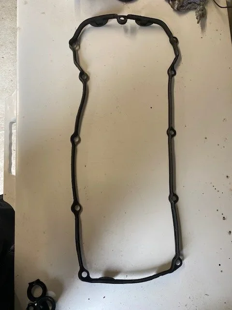

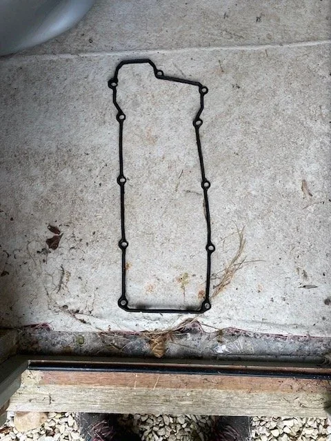

Hi All, I have come to do my gasket change today and using the above advice ordered the following part;
https://www.autodoc.co.uk/elring/76...MI1uSHkr3Y8AIVB-J3Ch1iawC9EAAYASAAEgLJqPD_BwE
After doing all the disassembly work I excitedly tried to refit the new gasket I ordered only to find that the profile is different (pics below) (2183 is the one I removed and 2184 was the new one I bought). Given the obvious difference I have clearly got the wrong one for my car (1997 2.8).

Note please that according to auto doc both of these fit my car when one clearly doesnt!

Looks like you have the M52B28 rather than the M52TUB28 with double Vanos.

Did you not use Real OEM to get the part number for your car?
Adam Hawkins
May 21, 2020
28
Burton On Trent - Staffs. UK
Z3 2.8 1998
Sadly not. Though I now realise I should have! Having now checked the realoem part number against the autodoc website I had indeed got the wrong gasket set so if anyone needs a gasket set please get in touch and I can organise a small fee and postage. Thanks for the help as always
