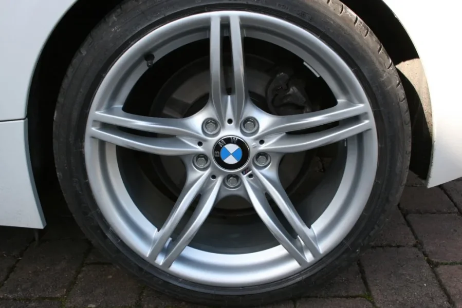

I did a full set of 326M wheels on one of our E89s. They were in a terrible state, with chunks ripped out them. I don't have a 'before' picture but this is how they turned out....

@Pond - was that Titan Silver Halfords paint on or rattle? Your refurb looks fantastic. Thank you for all the tips, playing card idea sounds inspired!

I only did mine 2 months ago so can't really give a full assessment but they still look great now
I am in regular contact with the chap who bought the E89 I did. He has no complaints 3 years on.
The 'BMW silver' paint was rattle cans from Halfords, although it looks like they have changed the way they do paint colours. It seems to be all codes now.
