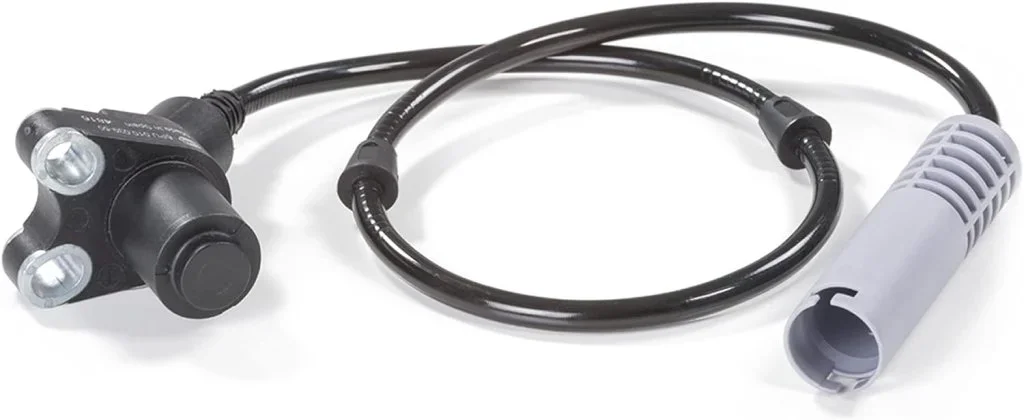

This may be a silly question but when fitting the rear sensors which have 2 holes, which hole does the bolt go through for left and right fitting. If the sensor is bolted on using the wrong hole I assume the sensor head is not aligned 100% with the reluctor ring?
Never seen one with 2 holes Ken, do you have any pictures. The reason I suggested silicone spray wasn’t for the contacts directly (ie for bad contact) but to make sure the plug and socket were fully connected.

The actual rear sensors have 2 holes is what I mean
Yep, but as I said I've not seen an ABS sensor which had 2 mounting holes for the hub.
Not 2 holes in the hub, 2 holes on the sensor. As i asked above depending on which side its fitted, does the bolt go through the left or right of the holes on the sensor
That's what I was getting at Ken. I've never seen a wheel sensor with 2 fixing holes before. I don't see why they would make one like that. If you measured the distance between the centre of the fixing holes and the centre of the sensor it doesn't look as if there is a difference?
Well, initially I was following instructions from pelican parts on how to fit the rear sensors and it's they who stated that dependent on the side the sensor is fitted would also decide the bolt hole on the sensor you would use.
Trouble is, their pictures and directions are not particularly good in this instance.
I certainly understand what you are saying but why have 2 holes then? Other manufacturers may also make use of these but I can't really seeing them specify fitting 2 bolts to secure it surely.
