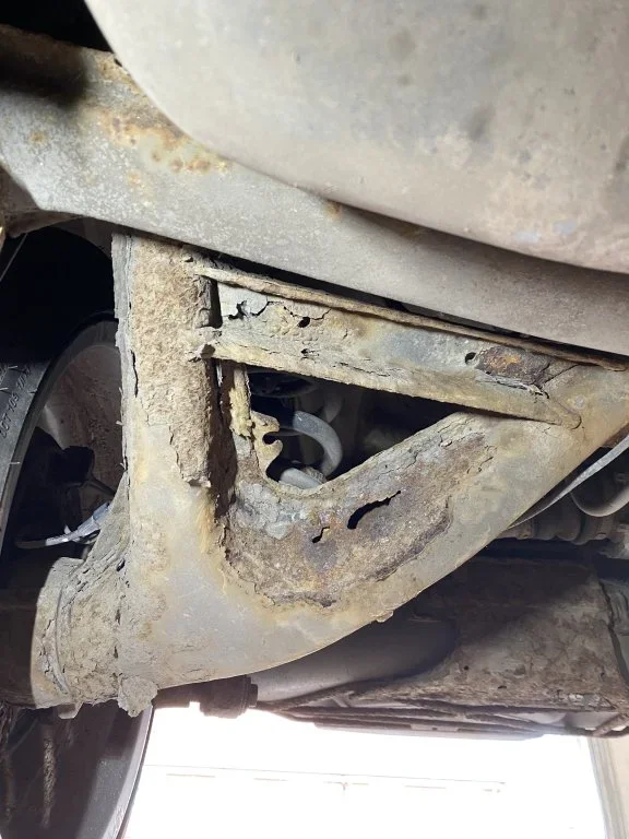

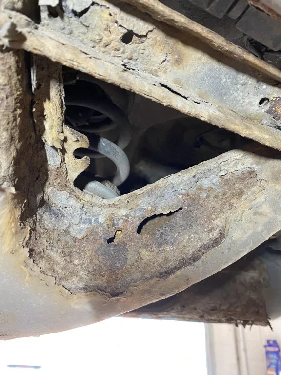

I have finally gotten around to replacing the bonnet release cables, and inevitably had a proper look at the car's undercarriage yesterday with my mechanic. To think of it, I might have been semi-consciously postponing this moment, just enjoying the smooth ride and the beauty of the car.
I expected corrosion, and there is indeed a lot of it throughout. The mechanic wasn't particularly concerned (apparently he sees a lot of rust on recent cars) until he had a closer look at the rear wishbone right-hand suspension unit: here it is. Unlikely to pass MOT. The man tapped on the other unit and while not as bad, he did express concerns.
Essentially I have 6 months to fix this. And I want to fix it. What do you think are my options, please, and is there a reasonable thing to do without spiralling into +£1.000 expenses? Can this be a welding job? A second-hand parts project? I'm not sure how expensive a new unit is (tried Google but struggled deciphering the results).
I'd also like to spend time and effort treating the rest of the corrosion, slow it down as much as possible - I unfortunately do not have access to a ramp, and don't know how many tools I need (jacks, etc?), but I am willing to learn, acquire these, and maybe travel, even a couple of days, and perhaps apprentice under someone who's done this before on theirs and would be willing to give me a few tips. If that won't be an option, any suggestions on how to best approach this would be appreciated!

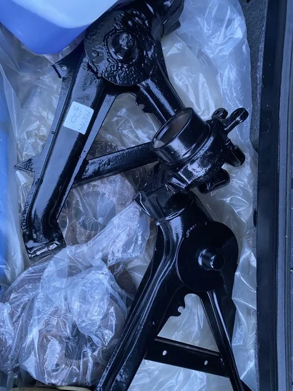

I have also acquired a respectable pair of second-hand trailing arms for him! I did so via FB Marketplace. Thank you everyone for your private recommendations, much appreciated. I got the arms from a young man who, together with his father, are restoring and enjoying these cars. Amongst the sights upon pick up was a very nice Z3M roadster.
The trailing arms need painting and some derusting; I brought some equipment and will be posting my progresss. :) My mechanic gave them the seal of approval, saying they're 90% better than the old ones.
As for undercarriage treatment, I am inclined at the moment to wirebrush everything then apply waxxoil. I'll consider a more permanent solution later.

Aside from a calliper sticking (replaced), I'm looking to fit the new trailing arms ahead of the MOT later this month. I will be powder coating the replacement arms soon. I'm looking at acquiring a few bits and bobs for the job and was wondering what the best places to buy from are!
- rear wheel bearings
- rear disc backing plates
- trailing arm bushes
- handbrake shoes
Many thanks and have a Good New Year!
Always worth looking at Autodoc and Carparts in Motion to compare Brands and prices. Meyle and Febi brands seem a popular choice for many. ebay also worth a look. All depends on your budget at the end of the day.
Th first link are the trailing arm bushes..need 2 bushes per trailing arm. If the back end is out already then get the beam bushes (your second link) done as well as if still original they will be shot. You need 2 of those, one for each side. Diff bush I wouldn't trust many garages to do that properly.
For the Diff. a Poly bushes is easier to do.
Thanks for the replies
So the old trailing arms are still on the car - plan is to replace them with the other (newly painted) ones in as minimal a procedure as possible - I think I'll stop by my mechanic and ask him what and how many bushes are needed. I'm satisfied with how the car drives now so am not looking to replace other bits unless necessary.
