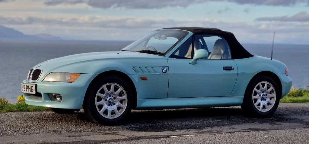

Just looked at your pics a Turquoise Green 2.8 with a hardtop nice find .
Rare colour we have a 1.9 in Turquoise Green in my collection. 20220312_161259.jpg
Rare colour we ave a 1.9 in Turquoise Green in my collection. View attachment 314931
Stephen
apparently we are the 'rare' z3 clan hahah
