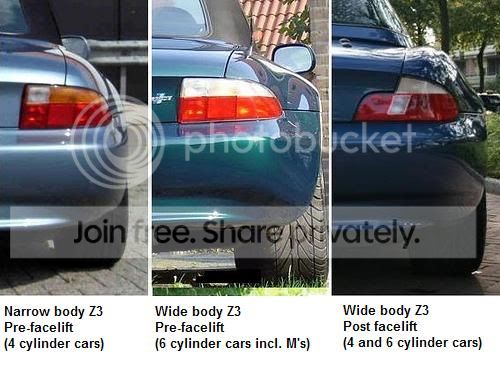

2.8s had wider rear wings and axles
2000 Facelift changed:
all models had wider rear wings and axles
remote central locking
headlining in hood
rear light / boot shape
wider rear arches and bumps over the wheels

they share the same rear wings as the 2.8 wide-body but have a shorter rear axle and run rear wheels with a crazy low offset.

widebody and facelift Z3's have a rear ET 37
slimmer body Z3's have a rear ET of 41
