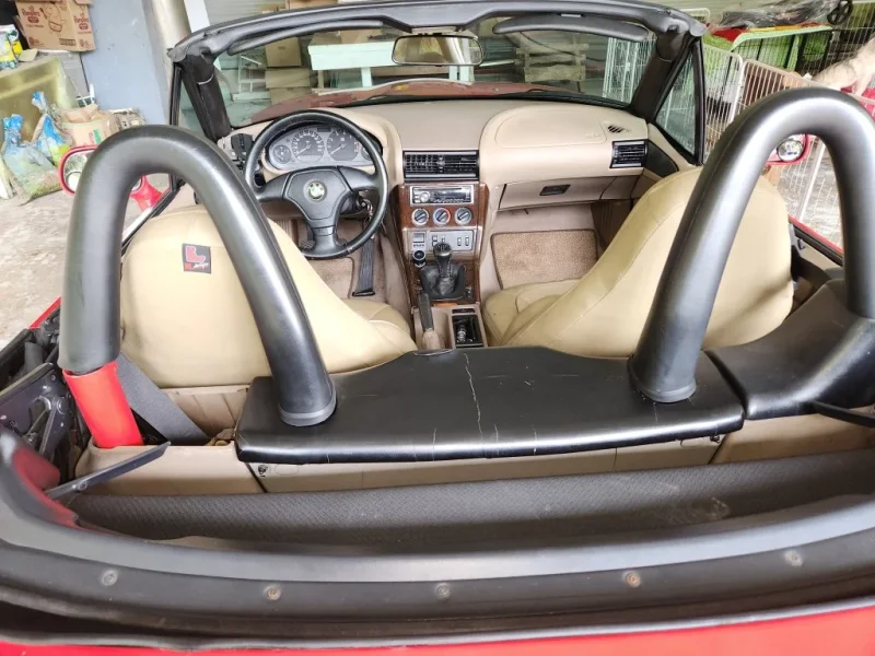

Ok, I'm going to try again. Every video on YouTube about removing the hoops (roll bars) on a 1997 Z3 roadster shows the plastic covers at the shoulder having a "hatch" to access bolts to remove the roll bars.
I previously posted that my car DOESN'T have these access points nor are there any bolts to loosen and be able to remove the roll bars.
However, the only person to respond to my question showed me pics of the very version I DON'T HAVE.
I've attached some photos so you all can see what I'm dealing with in the hopes that someone in Z3 land can tell me how I can 1. Remove all this stuff and 2. Find a replacement rear deck preferably one with the storage compartment(s).

Appreciate you posted this before you got answers on the other thread, but just incase you don't see those - what you have here is not a 'different version', this is a Frankenstein creation a previous owner has hatcheted together with all the finesse of a drunk hippo rollerblading through a china shop during an earthquake. You're not going to get disassembly instructions unless you can track down the guy who did it. And if it was me I'd be laying low 🤣
Personally I'd take an angle grinder to the lot and look on ebay for a full kit of hoops and plastics. I'd also be wary about what other "DIY" I might uncover elsewhere!!

I think a previous owner has covered up the hatch and painted over it. In your photo 103113 I’m sure I can see the edges of some tape covering up the hatch. Bash it with a hammer and you’ll probably expose the previous DIY job.

Thanks for your reply but, I don't think this was a home job. The pieces are too well formed rather like factory made. I think the car came like this out of the factory in the Fatherland. How could someone get these custom made and at what cost? It makes no sense to do that.
In addition, other pics and videos I've seen bolts toward the middle of their posts holding the hoops in, whereas on mine these bolts are not in evidence.

It is custom, as you have been told countless times in three different threads.
What you don't seem to be grasping is that by 'custom' we don't mean BMW carefully crafted this unique version in the factory, we mean joe public has gone at it with his favourite hacksaw and butchered it until the OEM hoops fit into non-hoop trims.

Rip it out by whatever means necessary and source the proper parts, or leave it alone and hope that you don't have to rely on it providing any roll-over protection. What I can guarantee is that starting a new thread asking the same question again is not going to yield a different answer.
They are not custom made, they are the original plastics. Not all Zeds were fitted with roll hoops, they were an option specified by the buyer. They weren't even an option on the very early production models. On the ones with no hoops the plastics didn't have holes for the hoops or access for the bolts to fit them and no inner brackets fitted under the center cubby box.
What you have is a non hoop car that a previous owner has cut holes in the original plastics to fit the hoops rather than go out and buy the correct plastics required for the job.

Those who said so we're correct: the plastic top to the rear deck WAS in fact a custom job though not entirely without merit which is why it fooled me. I busted through with a rubber malet in a fit of temper. There I discovered that the hoops once had bolts holding them in place but are now missing (Anyone know the size?).
Further they were just inserted so banging them upward I was able to remove them. The plastic where the seat belt exudes broke in my hands under pressure. They (like most of the plastics in this 1997 BMW are brittle and fall apart easily. They are however BMW parts, I would think, as they say BMW and have the logo stamped inside of them.
Now that the mystery of the Pernicious Plastic and Roll Bars is concluded; my most heartfelt apologies to all. I am am a car guy but apparently it only extends to the Jags I've owned and loved. Why didn't I just get another XK8? Hey, this is the Philippines, try to find a decent mechanic. Especially one who can work on Jags.
So to the last item, I need to replace the whole rear deck. Anyone know where I can get the two shoulders the box, the top and the two sides. Of course I'll pay shipping.
