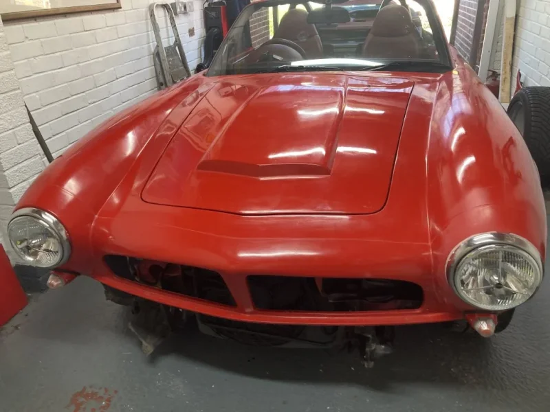

The gel coat has been wet sanded with 500, 1000 & 1500 before compounding with G3, and the results are very good. I’ve only done boot lid and smaller bonnet lid so far. I might buy a new sander to help as mine is old and was used heavily on other projects before.
My problem with the tripod lights was with the central cowl that shrouds the bulb. Even Nightbreaker 200 bulbs didn't give me the beam pattern or output that I wanted in an everyday car. Putting those bulbs in a standard config unit sorted that.
I got down to 600 discs on my DA sander before sending to paint. I've seen other polished gel coats and have been impressed with what can be achieved, especially the Z3GT at Stoneleigh this year.

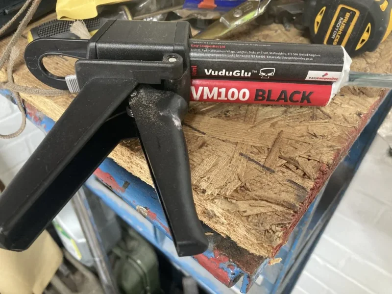

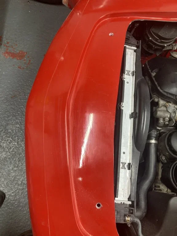

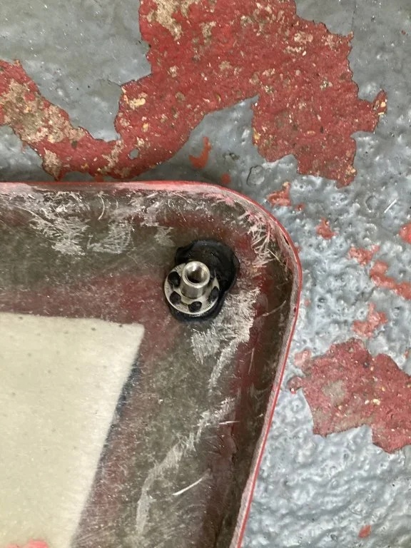

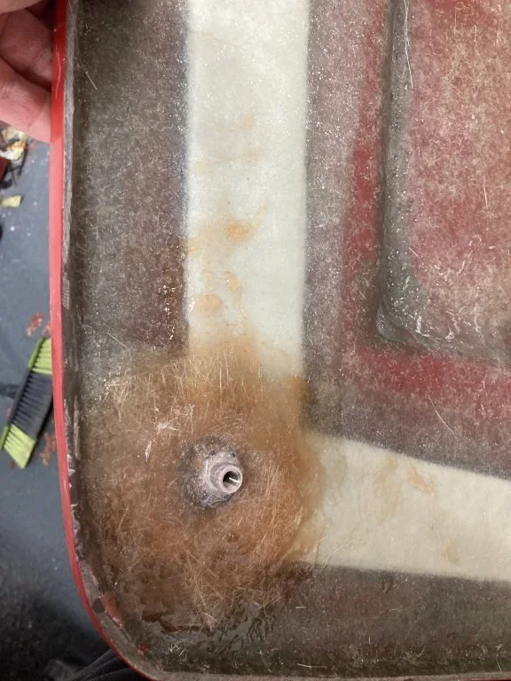

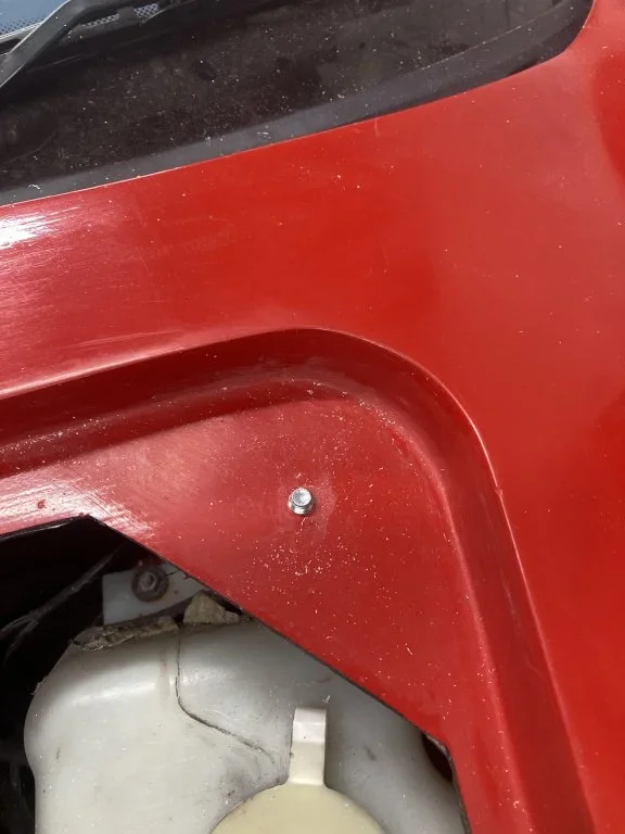

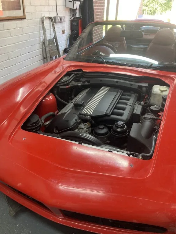

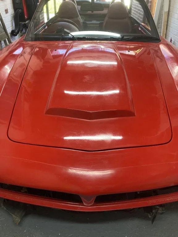

Today was playing with the bonnet insert and sorting out fixings. I used BigHead female blind collars which were stuck to the hood insert with ViduGlu. Once bonded I added extra grp to the front fixings for peace of mind as I don’t want it to part company whilst I’m driving.
once bonded 4 8mm bolts were installed to hold it all together.

Today was playing with the bonnet insert and sorting out fixings...

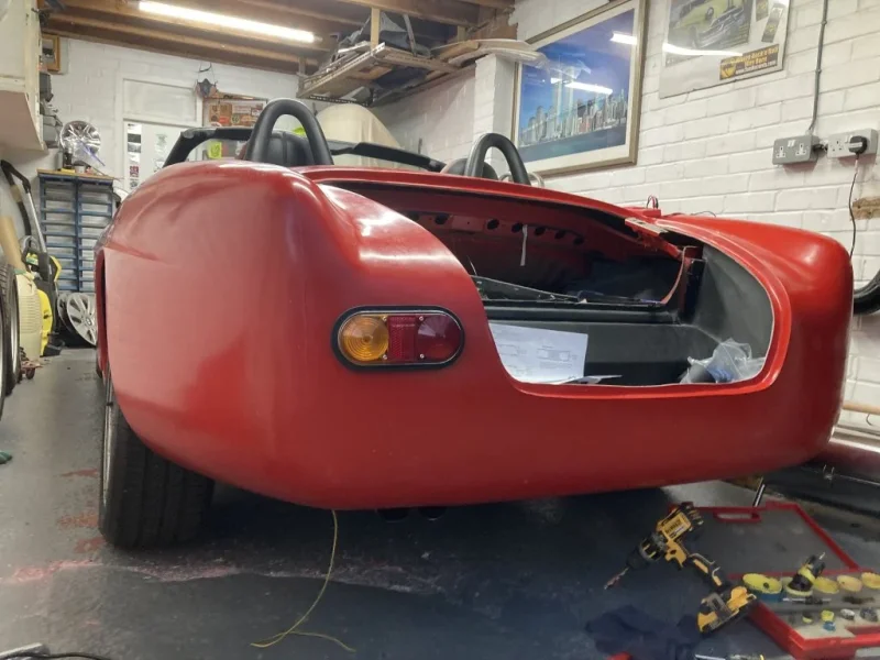

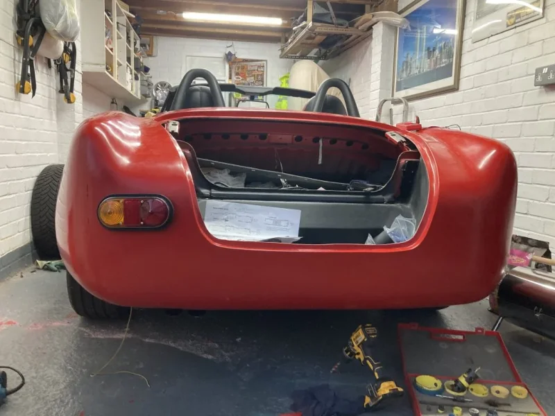

Been a bit slow but the rear tub is now installed And the nearside rear light unit. I just need to make a small bracket to mount reverse and fog lights under the rear edge. I have high power LED’s so they are small and hopefully unobtrusive

Today was like the hokey cokey with the bootlid, on off on off. Eventually a 2mm thick washer under one bolt
made the lid line up😁
I welded the locating ball back onto the bracket so both gas struts would work. These are the original Z3 hinges so the struts push on the hinges and not the bodywork or boot skin so it should not cause warping to the skin at a later date.

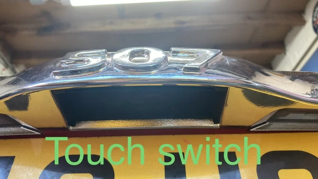

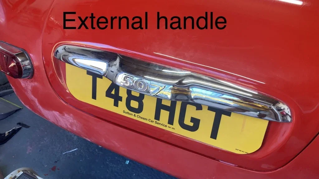

The 507 handle is now fitted and I’ll wire up the number plate lights tomorrow that are in the handle. Then it’s onto the lock mechanism.
The reverse and fog light LED’s were fitted on the lower edge and drivers side wired in. Passenger side to be wired tomorrow.

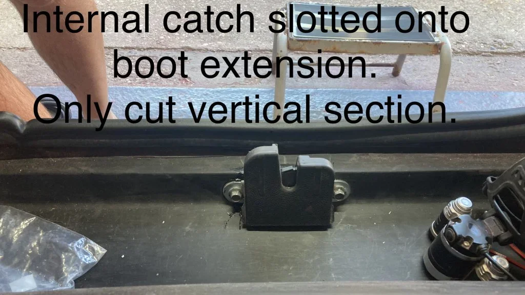

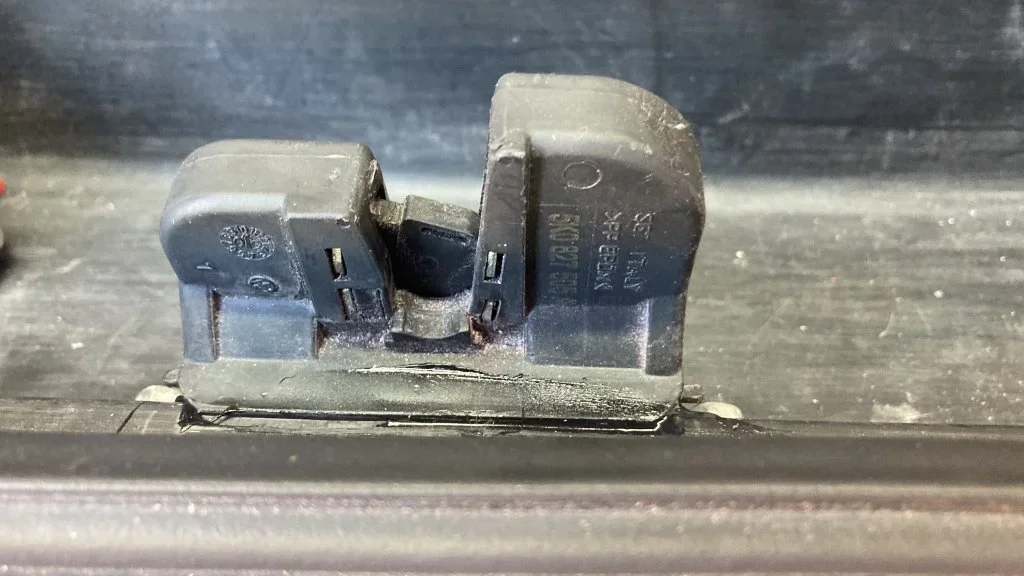

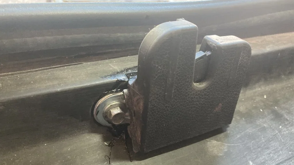

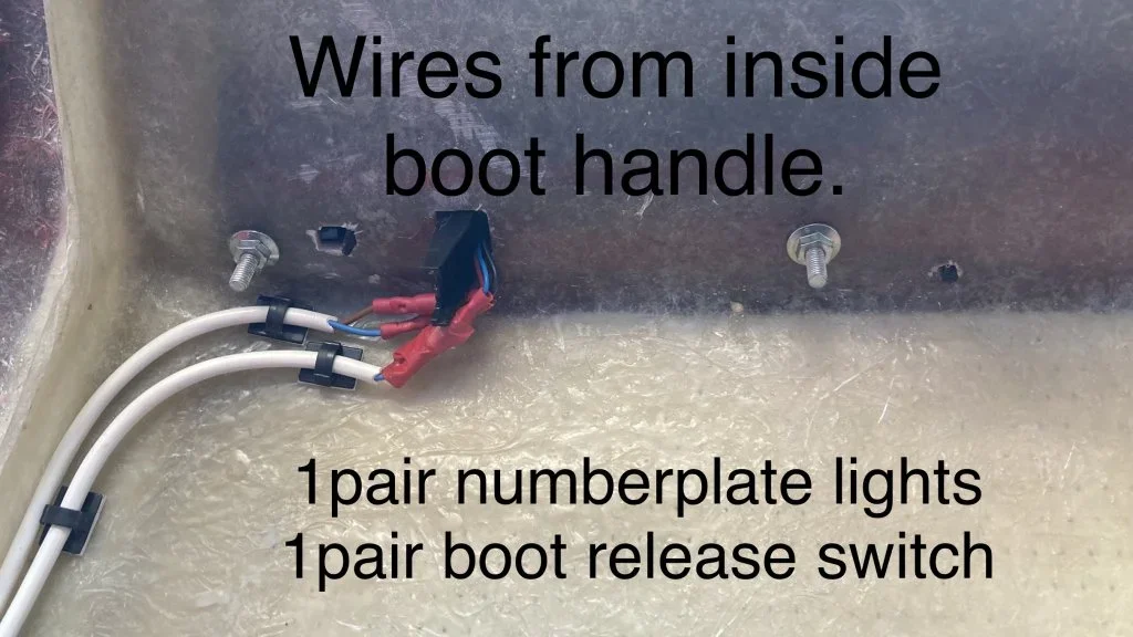

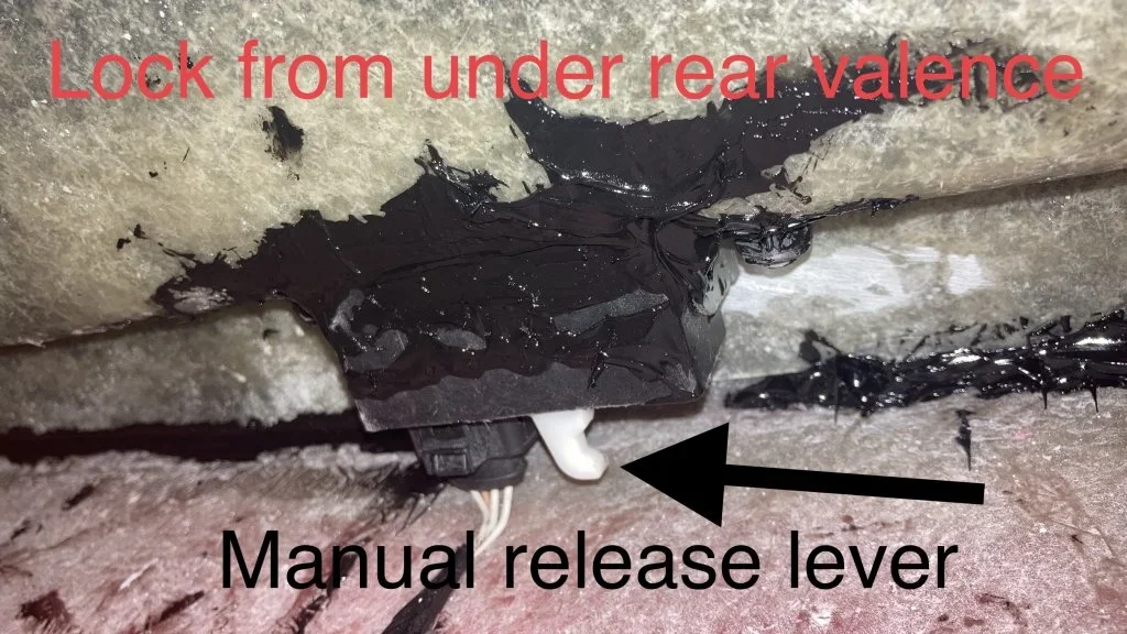

Time for the next instalment! Fitting the boot lock and release.

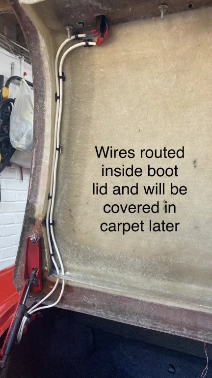

I’m using the Fiat 500 handle with a VW transporter electric boot release.
I have found a constant 12v live wire in the boot and ran a wire into the car to a hidden switch so I can keep the boot locked if needed. I haven’t found a way to make the central locking to work yet but have a few ideas that need researching.

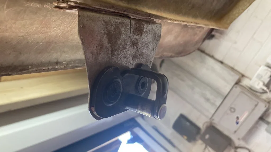

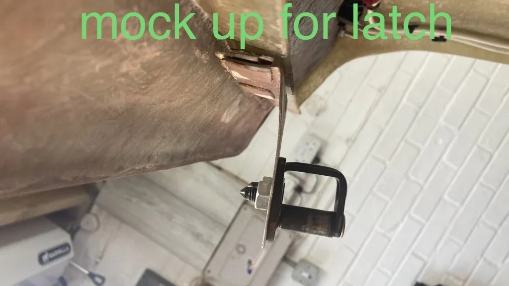

The latch on the bootlid will be braced with welded edges to box up the bracket and stiffen it, and then fixed into position on the boot lid. I can then adjust it height wise for a firm lock.
