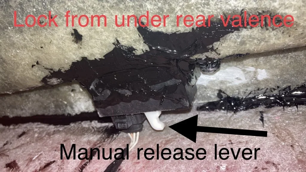

the lock is from a Golf or Passat and has 4 wires. Using a multimeter meter and a battery it was quick to work out which two wires operate it. (Brown was earth and three white wires)
I ran the wires into the car first so I could fit an immobiliser switch to keep the boot locked then back upto the handle and out to the lock
This is the electrical connection under the car, the white lever is a manual override should the power die so you can still access the boot

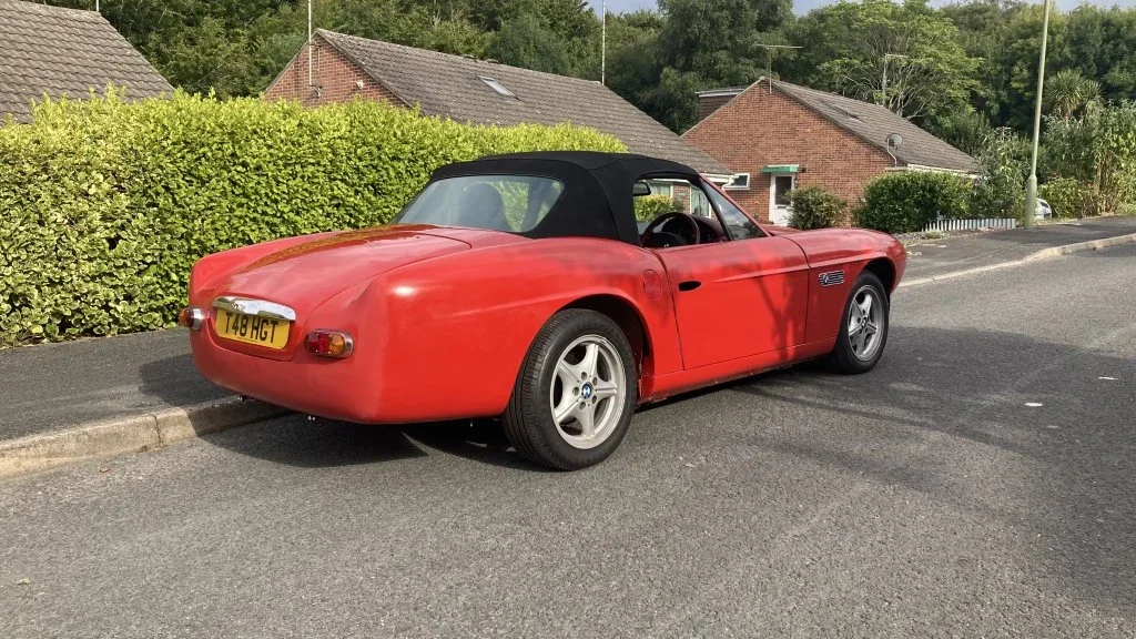

Here’s the wheels fitted with centre caps and spinners in place.
door handle changed to a Triumph Herald as the original Alfa Romeo I wanted to use proved too problematic.
basically it only had a 10mm push action which wasn’t enough to operate the lock and allow the central locking to still operate. This handle has approx 25mm plunger and works fine.
Door skin will be tidied up in due course

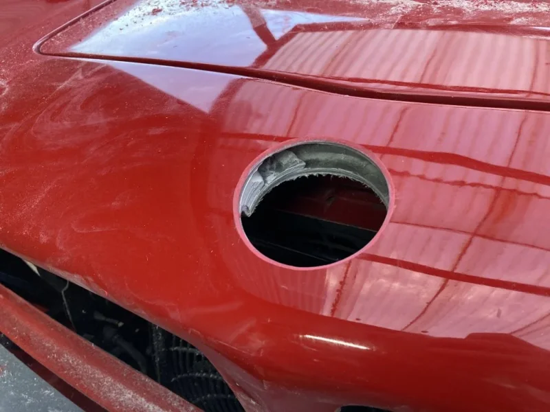

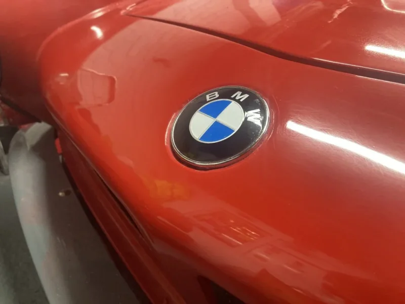

Door skins just getting ready for final fit. Bonnet badge recessed in traditional bmw style.
lower front valence fitted with number plate, and wing mirror installed. Nearly mot time 😁

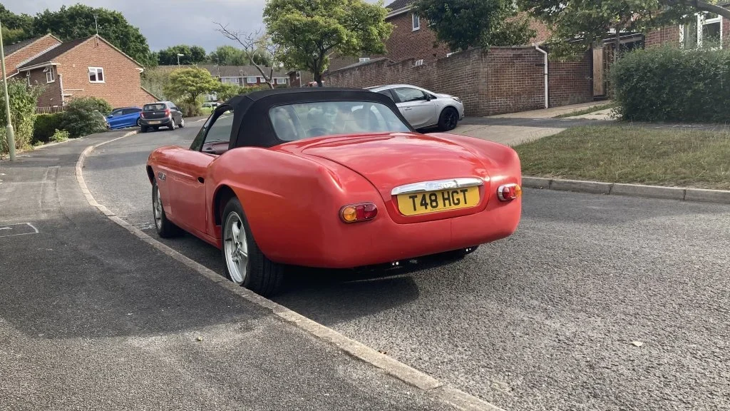

I’ve bought a rubber boot seal from Woolies which should clip on the grp. I will put seam sealer inside it to make sure it’s water tight and fingers crossed the water will run to the bottom edge. I will do the same on the bonnet infill too, so the engine bay doesn’t get soaked

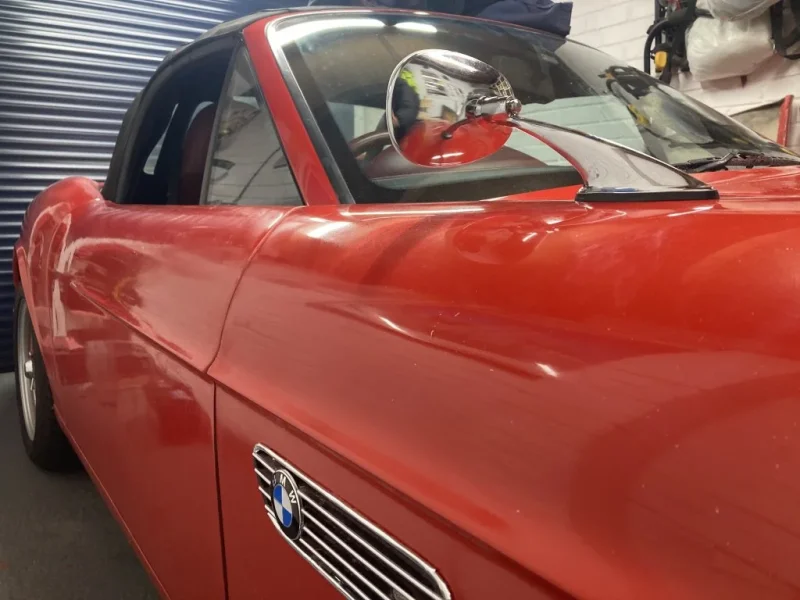

You may want to rethink the wing mirrors. They give a very poor rear view, door mirrors are far superior.
I have wing mirrors on my old Jag and they are pretty much useless so I also have small overtaking mirrors on the doors. Ideally I would like two remove the wing mirrors and fit door mirrors but that will entail welding up the holes on the wings and getting them repainted.
If you as Chris for a little gel coat you will be able to fill any holes in and match the finish/colour perfectly.

I went with the wing mirror as it mirrors the original cars, not for actual use and practicality. 😁
I'm not sure you know what I mean. I think you are talking about the boot leaking - I don't mean that.
When it rains the rain may sit on the boot. When you open the boot lid, that water goes in the boot. It looks like your problem won't be as bad as mine, as your boot slopes and the rain may just slide off it.
I think the boot slopes enough in all directions that it shouldn’t lay on the bootlid.
Fingers crossed it’s ok

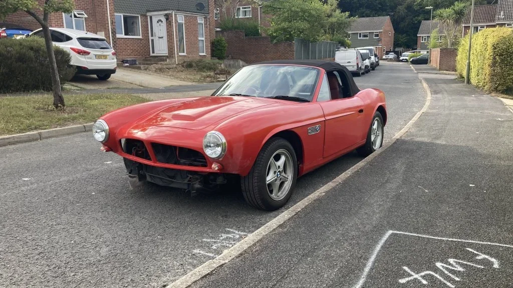

Apologies if I missed the details, but what have you used for rear and front lights? I am keen on doing something similar to what you have done.

Rear lights are Volvo P1800 units
Generic Lucas P700 tribar headlights.
VW Karmann ghia indicators with the metal housing. Tribute are doing an alternative set up using round Lucas lights as the VW’s are quite hard to locate and expensive. You will have the choice when ordering I believe
