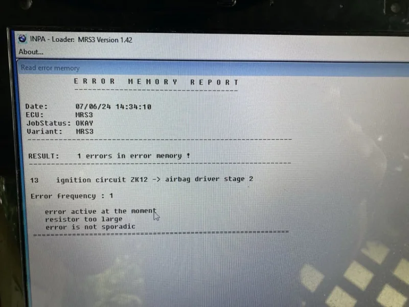

Hello all,
I am seeking some advice please. So the airbag light on my 2001 1.9 Z3 came on today. Initial check with my creator 310 plus followed by INPA revealed this - see attached. My initial thoughts and COA are to remove the steering wheel, check, clean, attach and/or repair any possible wiring problems. Same with the slip ring. All the fuses are good, the car is 100 percent dry and there has been no recent work.
I would appreciate any steers as to what else i might consider. If the issue is the slip ring, does that have to be coded/calibrated?
Many thanks
