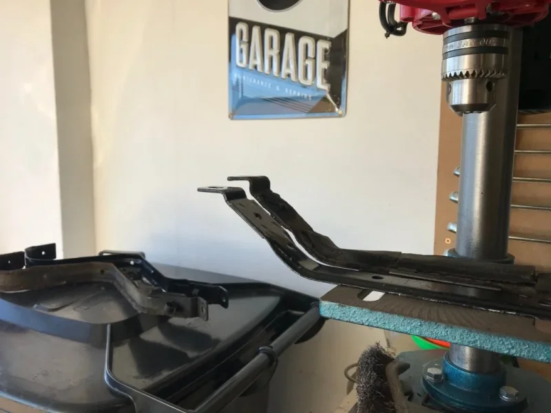

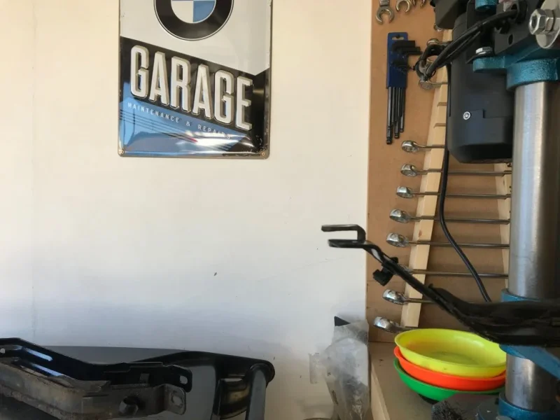

One thing that I did spot today was that the BMW straps I took off my car are different to the BMW straps I picked up a while back. It looks like the design was changed to possibly give more support to the tank.
This was the same on both straps. The hook end wasn't altered.
NB The new two piece replacement straps are based on the later version.
