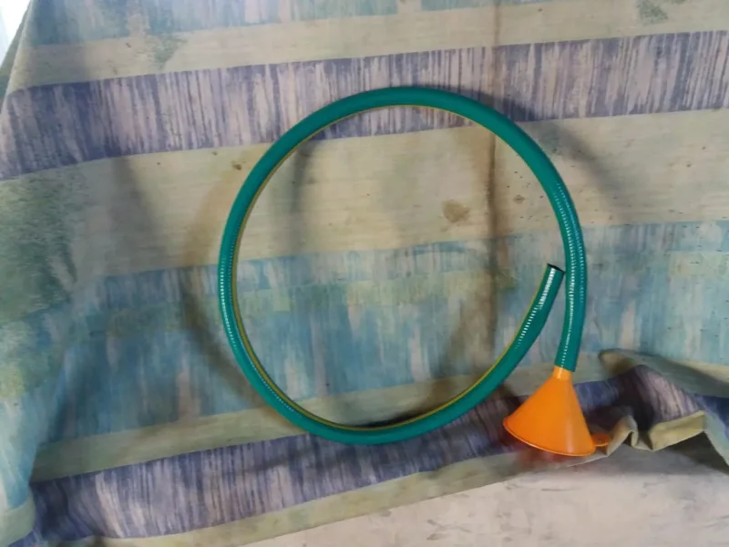

Don't waste money on a pump you won't use much. This is all you need to re fill the gearbox and the diff. on a Z3.
A small funnel and 1 metre garden hose.
I read that earlier in the thread , I couldn't believe the fill hole was that big . I've got plenty of the hose knocking about and probably a funnel .
Already for the oil (coming tomorrow), garden hose and funnel in place , drain plug re-inserted ;)
You still need your drain tray (not like the one @Grumps used;)) as when you get to the level you'll still have a bit left in the tube. From Saturday I can tell you after 1 full litre it takes very little to get up to level.
