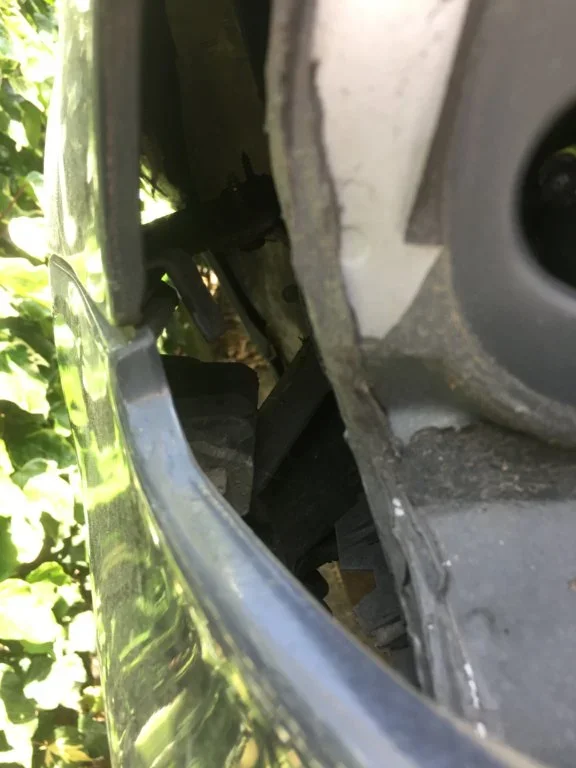

You’ll now be able to get to a very grubby 8mm screw just in front of rear wheel.

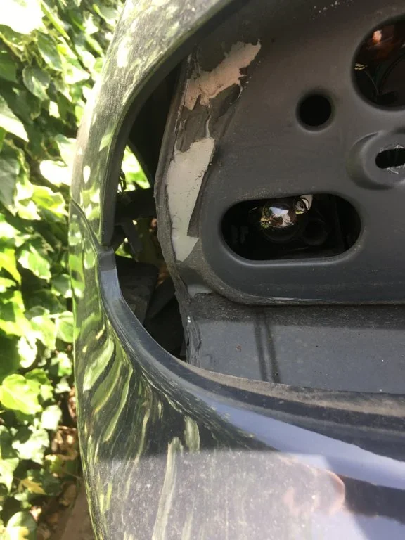

Then the hard to reach pair of 8mm screws on the inner mount between the rear wheel and rear lights can be removed, a long ratchet spanner is ideal. You don’t need the rear lights out, I just happened to have them removed already.

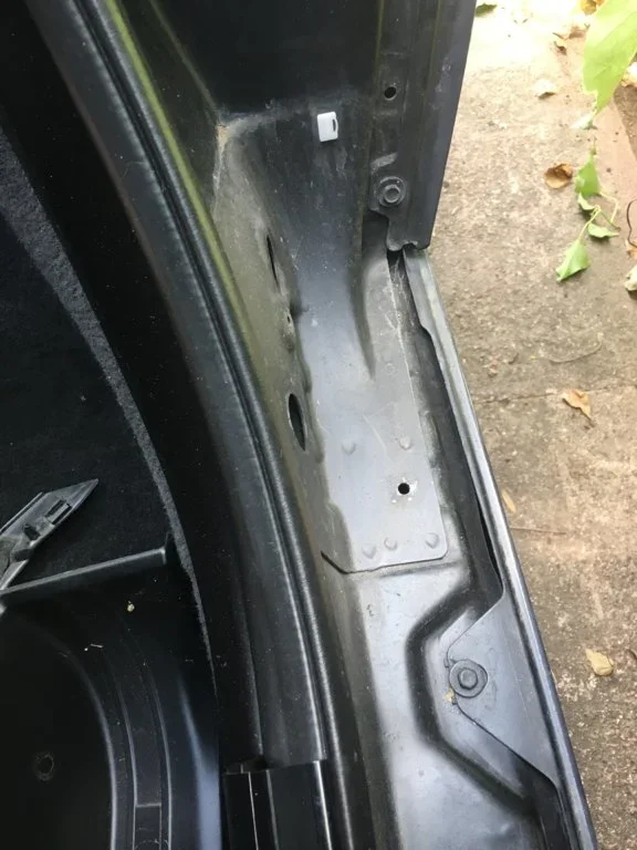

The two trims from the door entrance need to come off, brute force required, the tiny T shaped clips will almost certainly break.
This reveals a row of 8mm screws.

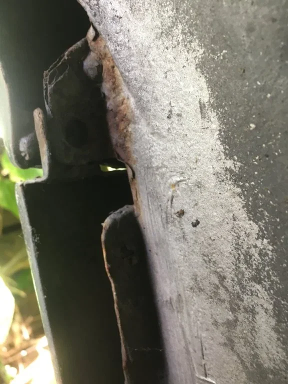

Then you can access the last row of 8mm
Then the whole thing lifts off.
This is the one mount that the hard to reach ones go through.
The one inside the wheel arch liner at front

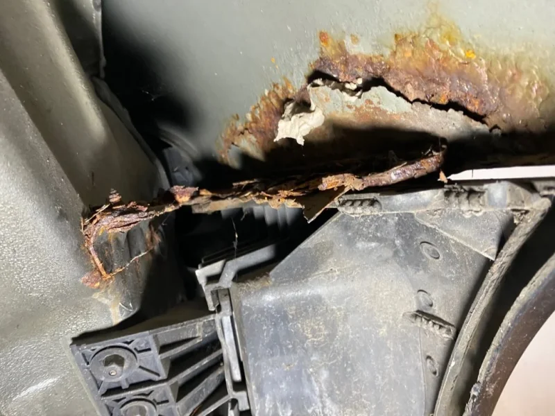

Thx, mine needs to come off today as found the bodge job the last owner did. Any available E36 wide body 2001 wings (UK passenger) out there?9C7E51BF-8E73-41E7-96BE-775EE7F4CF77.webp
