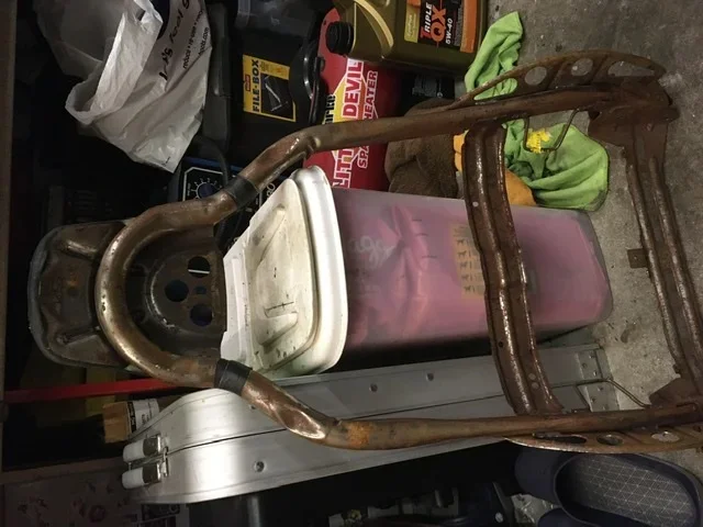

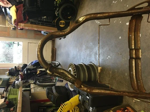

Ok. To start with, here is a comparison of the two types of seat back frame. You can see that the later one has a welded on plate on the top hoop- that is the only significant difference, and you can see how that affects foam and cover height.

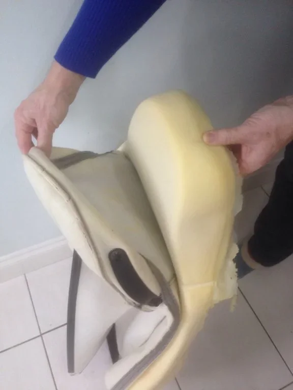

I too may have a problem with what I am intending to do.
Some time ago I bought a new set of heated seat covers and door cards from a BMW dealer in Guildford absolute bargain, or so I thought. The door cards are on my car no problem. The seat covers complete with the foam are for a pre-facelift car and the electrical plugs are changed on the facelift, which I have, I can get over this. If the frame of the seat is different that may be another matter. I have measured as best I can without taking my seats apart and they appear to be the same.
The new covers have the foam bonded to them. The seat belt guides are already fitted. One thing, the back cover is supplied with the leather inside out and I can't see how to get it over the head rest.
Any advice gratefully received.

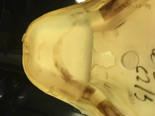

Not sure about the inside out bit, but if you have the taller seats but shorter covers, you could just remove the metal plate. If you can, post a pic of the rear of the headrest foam.
Here is a photo of the back of the foam. The metal plate seems to be incorporated in it, so I take it it is intended for the frame without the plate. However, I don't know which frame I have yet.
As regards the cover being inside out, I got my wife to assist and now it's in the right way. She is far more brutal than me.
As regards the cover being inside out, I got my wife to assist and now it's in the right way. She is far more brutal than me.View attachment 128403

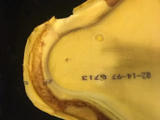

That's an early foam for the frame without the welded plate. The later taller foam doesn't have the large section behind the headrest area.
Early in photo 1, late in photo 2.

Yes-the plate is welded on but a grinder would take it off easily. The frame seems identical other than that.
