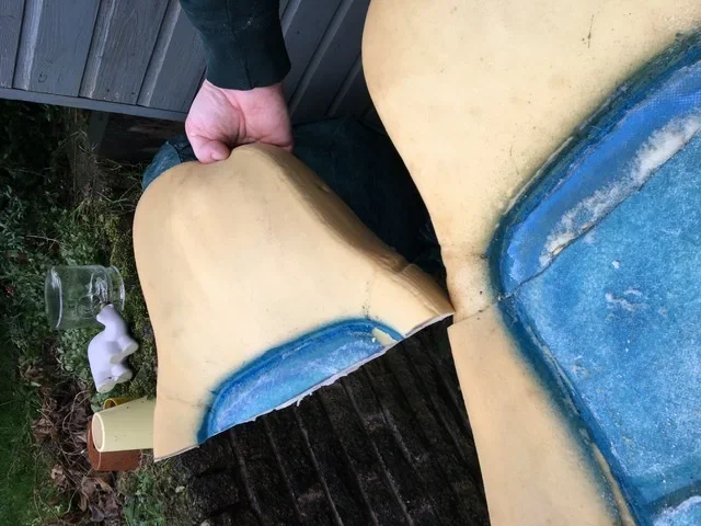

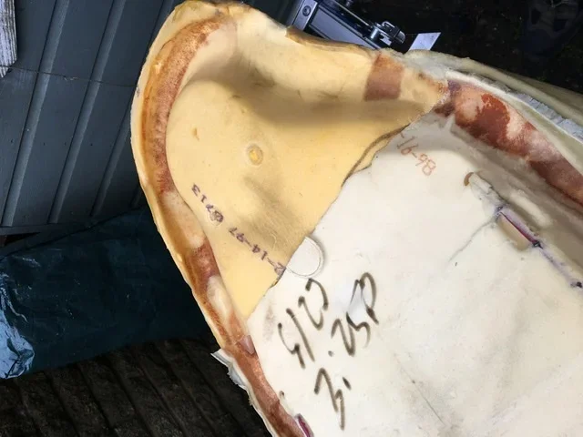

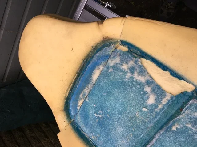

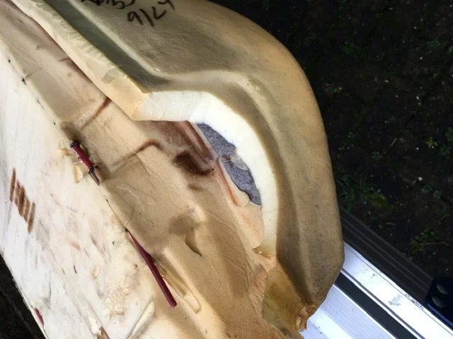

Ok- it went surprisingly well. The short and long foams are the same apart from the headrest area. We decapitated the old and new foams and stuck the old headrest area to the more modern foam with contact adhesive.
The only other slight difference in the foam is the lower outer bolster. Early foams have cutouts (not really sure why) but these are marked on the later foams, so we just cut them out with scissors.

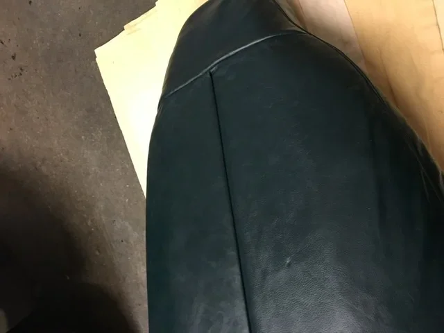

Then it’s fitting the “new” covers. Straightforward but I suggest you practice with the plastic locking strips BEFORE you fit the cover in situ.- fiddly!

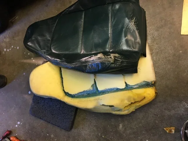

And so on to the before and after.

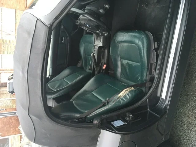

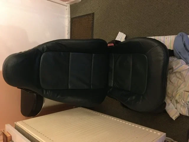

Severely ripped covers and shredded foam replaced with better (passenger) covers and later foam. The covers are still a little baggy at present but I fully expect these to settle with use. Naturally I did the rail bushes at the same time. Very pleased with the result.
