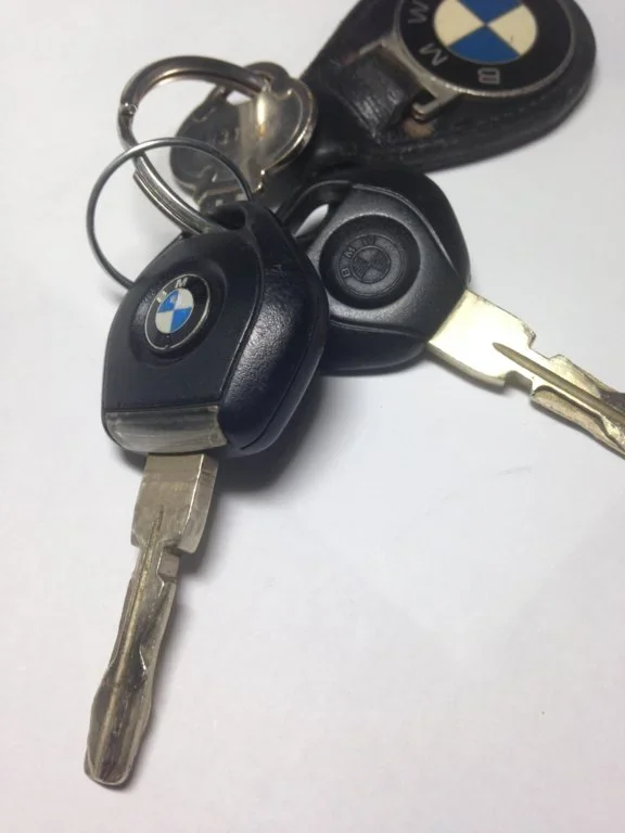

The car locks and unlocks with the key fine but only if you put the key in one way. Buttons to the rear but if you put the key in with the buttons to the front the car won't lock or unlock?
Next, I only thought when I got home but Dean's car is prefacelift but hasn't the diamond shaped key but has the later key type so can this be programmed in the same way.
ie
- Sit in the car with all the doors shut and windows up with your key fobs (all your fobs need to be done at the same time)
- With one of your keys turn the ignition on then off and remove the key
- Press and hold the unlock botton and then press the lock button 3 times.
- Release all buttons and the locks will bounce up and down.
- Repeat this with the other key/keys (press and hold unlock and press lock 3 times, locks will bounce)
Note: Only switch your ignition on once, doing so again while programming will reset the process and you will have to start again.
pic of key types
Dean has a type 1 as I do but I thought the earlier cars had the type 2 keys.
